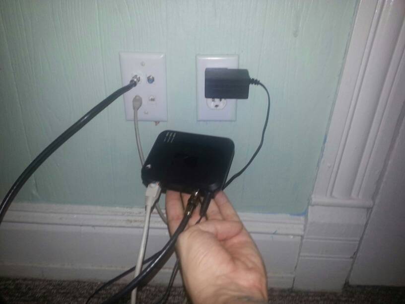

Broadband deca, its a black box that connects your setup to the internet.

I know what it does, I just never heard it called a bbd.
BBC is broadband converter an actually a different adapter. The bbc is used on nonswm setups for HD boxes (excluding the h(r)23 boxes)
The broadband DECA is the box that attaches to a Swm network introducing internet.
Bbd is this

So you still need an additional little box and power outlet. With the small size of the C31's and C41's, why not use that.
The cck is to introduce the signal to your home network, that doesnt need to be near the tv itself, i have mine in my reptile room, it could go in an attic or basement if wired thatway. Or near your computer. The benefit to having an rvu tv is the lack of a need for coax to that tv, only hardwired internet.
