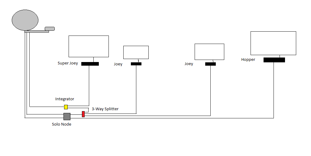

Terminating the client part of the solo node is an error based on reviewing previously released wiring diagrams for home based systems. You need the client part of the node to run into the integrator along with the 3rd line from the LNB. The position of the integrator is all wrong,it should be 2 lines running in(from client part of node & 3rd line of LNB) & one line running out to the Super Joey. I'm very far from an expert here,but from what I've read on this site AND from looking at the diagrams already released,this is crazy.

Here's a revised (3/13/2014) version:
http://rvseniormoments.files.wordpress.com/2014/03/555_dish_twotvs_hopper_superjoey1.pdf
On the dns forums (for Dish techs/employees) they stated that the power supply for a SJ isn't enough for the second side of a duo node. And thus would not work.
Well that sucks. What did they save in the SJ power supply? 10 cents? :rant: Obviously we need a power inserter to make this work.
http://www.satelliteguys.us/threads/331178-Super-Joey-Specs/page13
Go to this thread on page 13 of this thread,then go to message #76. There you can view or D/L the various wiring diagrams for the Super Joey. I imagine that you are using the Tap because you want to minimize the amount of cables running from the solo node. Take the Tap out of the picture,take the terminator off of the client part of the solo node & run the cable from there directly to the 4-way splitter & your diagram will be correct according to the diagrams I've already seen. While I don't know why a tap wouldn't work,I'd suggest that you test it out first yourself before you officially publish a diagram using a Tap. Go the "official route" first & then test with the Tap.

This has been posted in another thread but to make it more convenient here it is again. The one is a diagram I made myself.
Super Joey Wiring.png View attachment HopperJoeySystem_JobAid.pdf
Playing "devil's advocate," is there any reason why terminating the client port of the solo node & using a tap instead wouldn't work?
The moca and sat frequencies should all get to the right place, but the biggest issue is they want the integrator grounded to the node, which means it should be close to the node. But I have to wonder if the assumption is the node is being used as the main ground.
Whether the grounding is a "belt and suspenders safe" requirement or a "otherwise the Hopper/Node/SJ will turn to ashes after a week" requirement, we don't know (but I like being safe).

The moca and sat frequencies should all get to the right place, but the biggest issue is they want the integrator grounded to the node, which means it should be close to the node. But I have to wonder if the assumption is the node is being ised as the main ground.
I am sure it is because of building/installation code. Not grounding won't make everything burst into flames... ;)

I am sure in that situation if you added a third line and another ground block by the other one and bonded them it would be up to code. When running 3 lines for 3 VIP receivers it's what we're supposed to do.
They want the integrator bonded to the node rather than its independant ground location as to prevent a ground loop situation.
If the integrator cannot be installed near the node then a ground block must be bonded to the node.
This is assuming the node is grounded. If it is not. There is no point in bonding anything.
