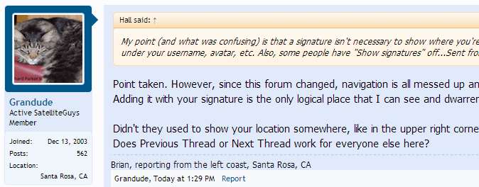

Point taken. However, since this forum changed, navigation is all messed up and it's not apparent how to put your location in.
Adding it with your signature is the only logical place that I can see and dwarren was nice enough to post it.
Didn't they used to show your location somewhere, like in the upper right corner. Maybe I'm confused with another forum.
Does Previous Thread or Next Thread work for everyone else here?
Can't really agree with that. I had never looked, but it took only one click to find it after reading this post. Under Personal Details under the user dropdown menu.
Switch to the Classic theme or ask Scott to add it to the other themes, or just click on the user name and it shows in the popup.
