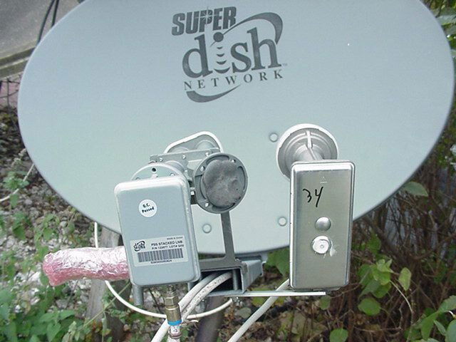

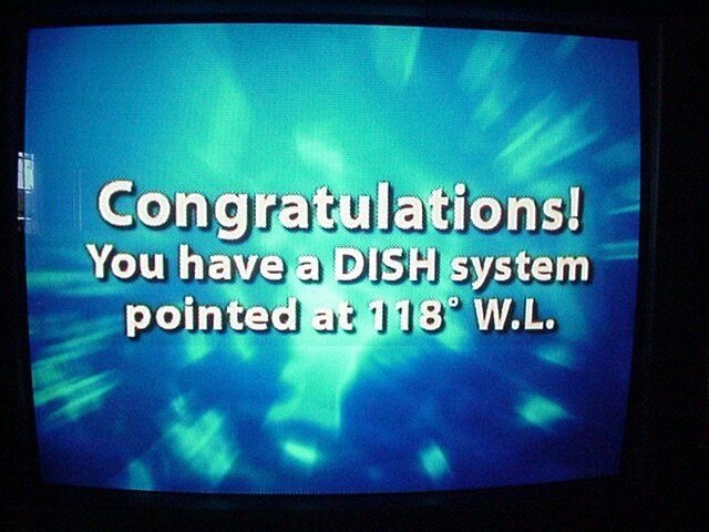

Does anyone else use a type 1 sd121 for reception of 118?
Without the kit of course.
Seems like a good tech tip, but may be nothing new.
What I do is just use the 121 fss lnb on the 119 circular feed.
The other lnb is for 129.
The extra slot covered with bubble wrap is for 110.
If you have a 121 dish. Does not require repoint. Just lnb swap. No 119 of course.

Repoint kit wasn't available back then. Plus I had the parts available. And I don't actually subscribe to anything on 121 or 118, just wanted to see if it could be done.
