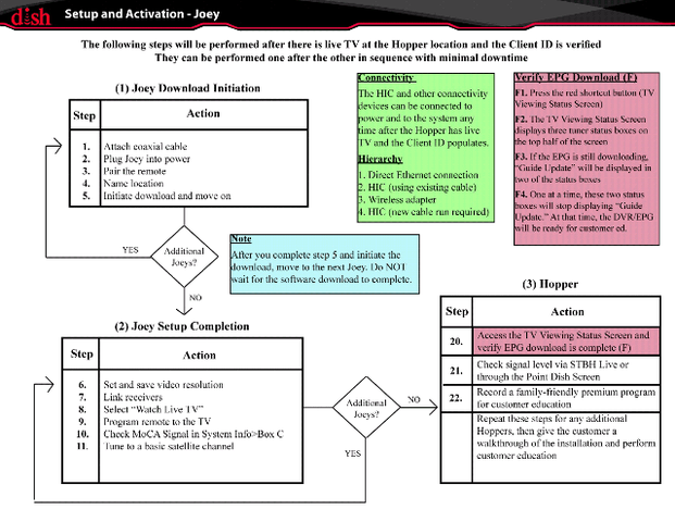

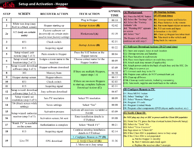

As for activating the Hoppers and Joeys. I read that we should activate the Hoppers and let them download the software first and then go to the Joeys. Can the Hoppers be done at the same time? Is there any order?
CCTX said:
We are fixing this now.
Don't even hook up Joey's to moca cables till after you check for client id, yes this is well after all recievers are activated and hoppers can view live TV.
