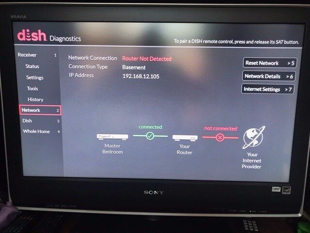

Good evening to you all. I am having a hard time connecting my Joeys to Internet. I know the basics and how it works. Few months ago, I had no trouble doing it when I replaced my dish remote with a new voice activated remote. Google would respond to my voice commands on tv connected to Joey. Couple weeks ago I changed my wifi password and successfully did the same with Hopper 3 settings. ( changing pw and watching YouTube to be sure.)
Today I opened the YouTube app with Hopper and was able to watch few short videos.

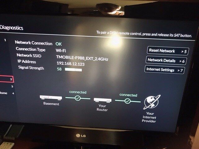

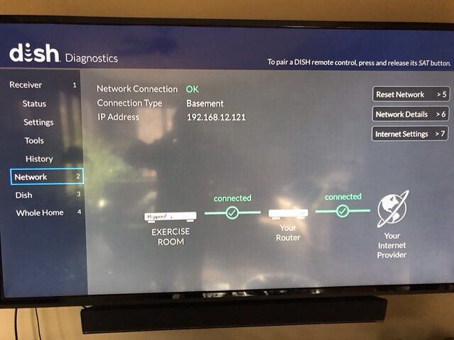

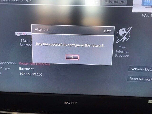

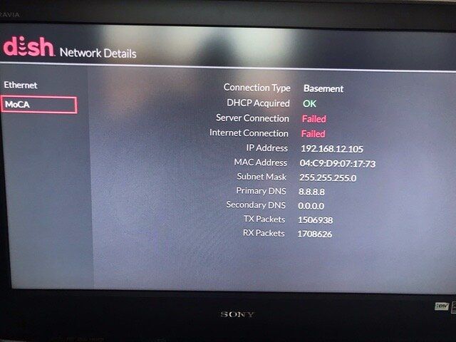

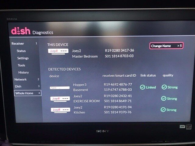

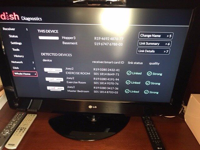

the first and last pictures attached show the hopper internet settings. Later I checked the internet settings with one of the Joeys and realized Joey was not showing internet connection. I did the usual with resetting connection. Whatever the reason is it will not connect. The other pictures show what I am talking about. I tried all 3 Joeys with no success.
At this point I have no idea what to do. Nothing changed since I used a Joey with internet connection. Hopper shows ' bridging' is on. That feature is greyed out with Joeys, meaning it is not possible to change it from 'off' to 'on'.

How is your Hopper connected?? Is that a HotSpot? Are you using Extenders?? if so, don't connect the Hopper to the Extenders. That's the number one issue I see where it comes to similar issues like you're having and I've seen a lot of issues with Hot Spots/MiFi's.

Thank you for your responses. Yes, Hopper is connected to a range extender.
Here's my set up:
A T-Mobile modem/router on second floor (next to a window for better connection to a cell tower), A range extender on first floor, Hopper in the basement, 3 Joeys in basement excercise room, first floor and a bedroom on second floor.
I am under the assumption that the wifi signal won't deteoriate too much if I use an extender in the middle which is the first floor. I should also mention that I use Roku on another tv (with Joey) in the basement. During that setup, I chose the gateway (no ext, either 2.4 or 5 GHz). The signal two floors down was good. No issues with streaming with Roku. I will go ahead and change the internet setting on Hopper from extender to the can (T-Mobile gateaway). Perhaps, I used that connection when it worked in the past, and I forgot about it.

Usually it's not the signal quality/latency from the gateway that causes the issue, but rather the internal network bridge on the Hopper's having problems when connected to extenders. If I were to guess it's because the Hopper is trying to relay traffic using the Joeys IP address, and to the router this looks like one MAC (the Hopper's) is broadcasting under multiple IP addresses (its own then it's connected Joeys). To a normal router this is not a problem, but some repeaters (unless they are mesh, and even then some don't work that well either) will get confused and not relay secondary IP's to the primary router. This is just a theory since I don't have an extender anymore to test (lucky me) but it's something I ran into sometimes with other devices when I had them.
Ah!!! Big relief. HIPKAT, you the man!! It worked. I changed the network setting on Hopper from extender to modem/router combo. As I expected the wifi signal dropped from 60s to 30s. It now fluctuates between 30 and 45. I tested the streaming quality with Youtube. It was fine. Then, I checked the settings with joey. It connected right away. Check the picture.

Don't use range extenders when you set up Hopper Internet settings. Direct connection to the router.
