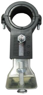

You can often find the rectangular mount linear FSS LNBFs on Ebay that fit into the original arm mounts. If not, most use the generic LNBF clamps with adjustable riser section. This design allows the new LNBF feedhorn/scalar to be placed at the same position as the original LNBF.

The LNB holder that Titanium posted a picture of above are the ones that I use on my Slimlines and the 18''x20'', with PLL LNBs. I removed the original LNBs, cut a small board to fit tight into the end of the arm where the old LNB slid into it and then mounted the bracket onto the board.
