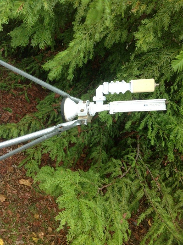

They are still all over at gas stations and commercial retail outlets here. Those commercial LNBs that look about a foot long or more make our baby LNBs look silly.
The LNBs are only a few inches long. The transmitter (buck) is the big device that you see on the arm. It usually can be easily removed, leaving only the feedhorn, waveguide and LNB.
This is the LNB that is on my 1.2M. Fits what the discussion is describing. Top one is the KU LNB. I swapped out the transmitter for a C Band freq unit, but could not get it to work. This is an outstanding LNBF and dish for KU Band. This is on my get rid of pile.... I'm using the pole for a 2nd c band dish...
The feedhorn and waveguides are on these RX/TX units are designed for KU-band frequencies and are often blocked for polarization as well. The feedhorn and waveguide would not work for C-band.
