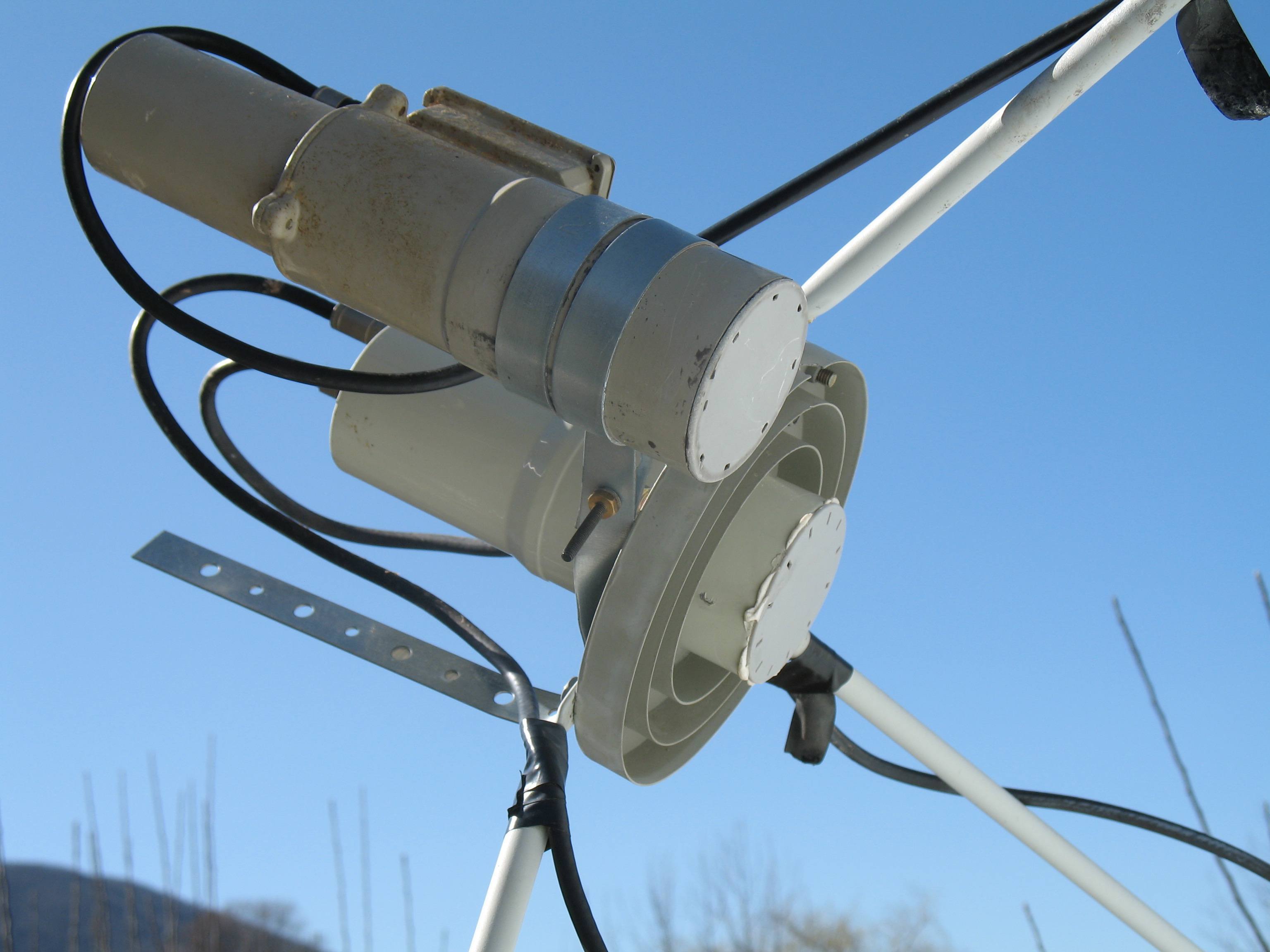

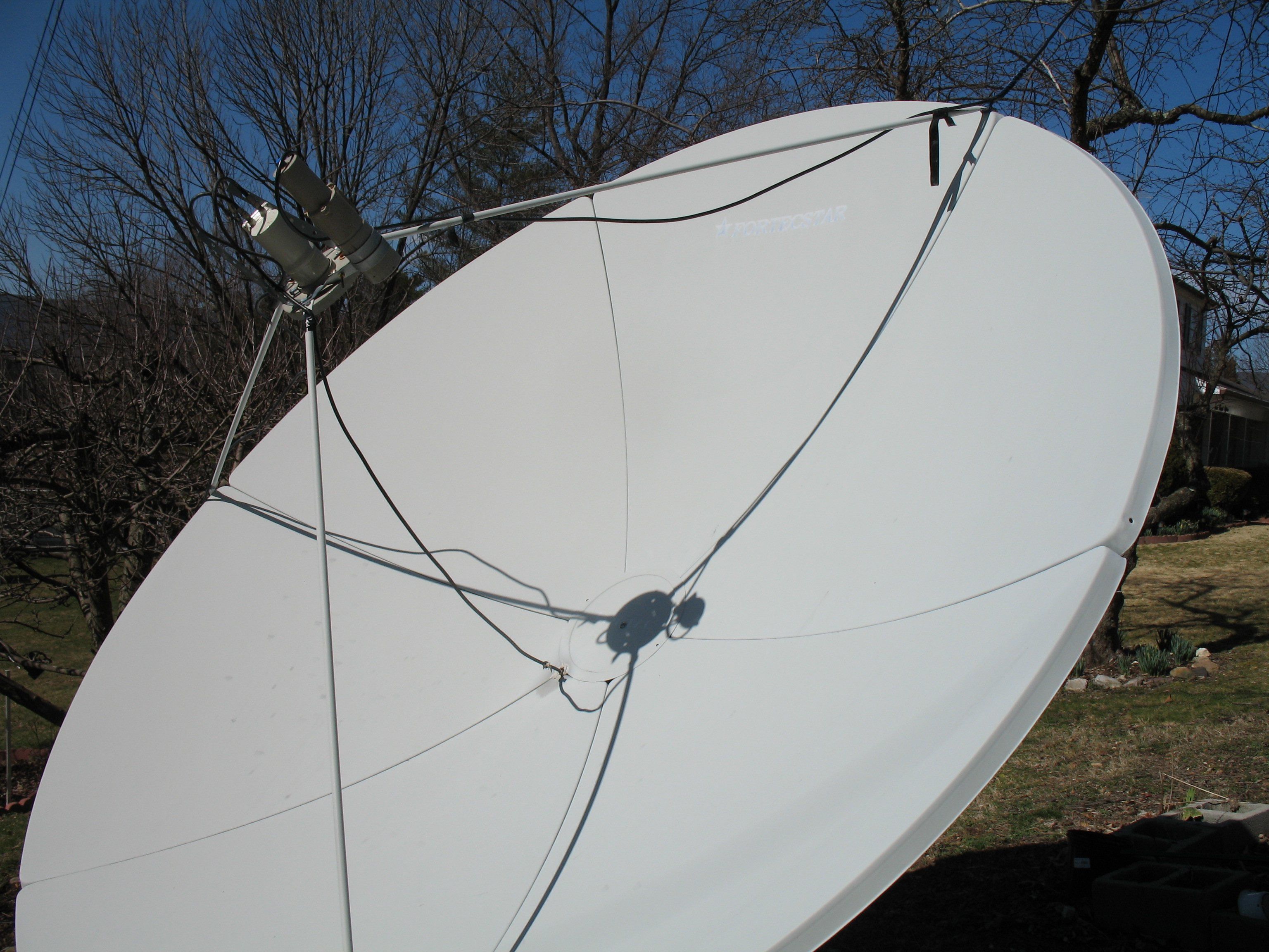

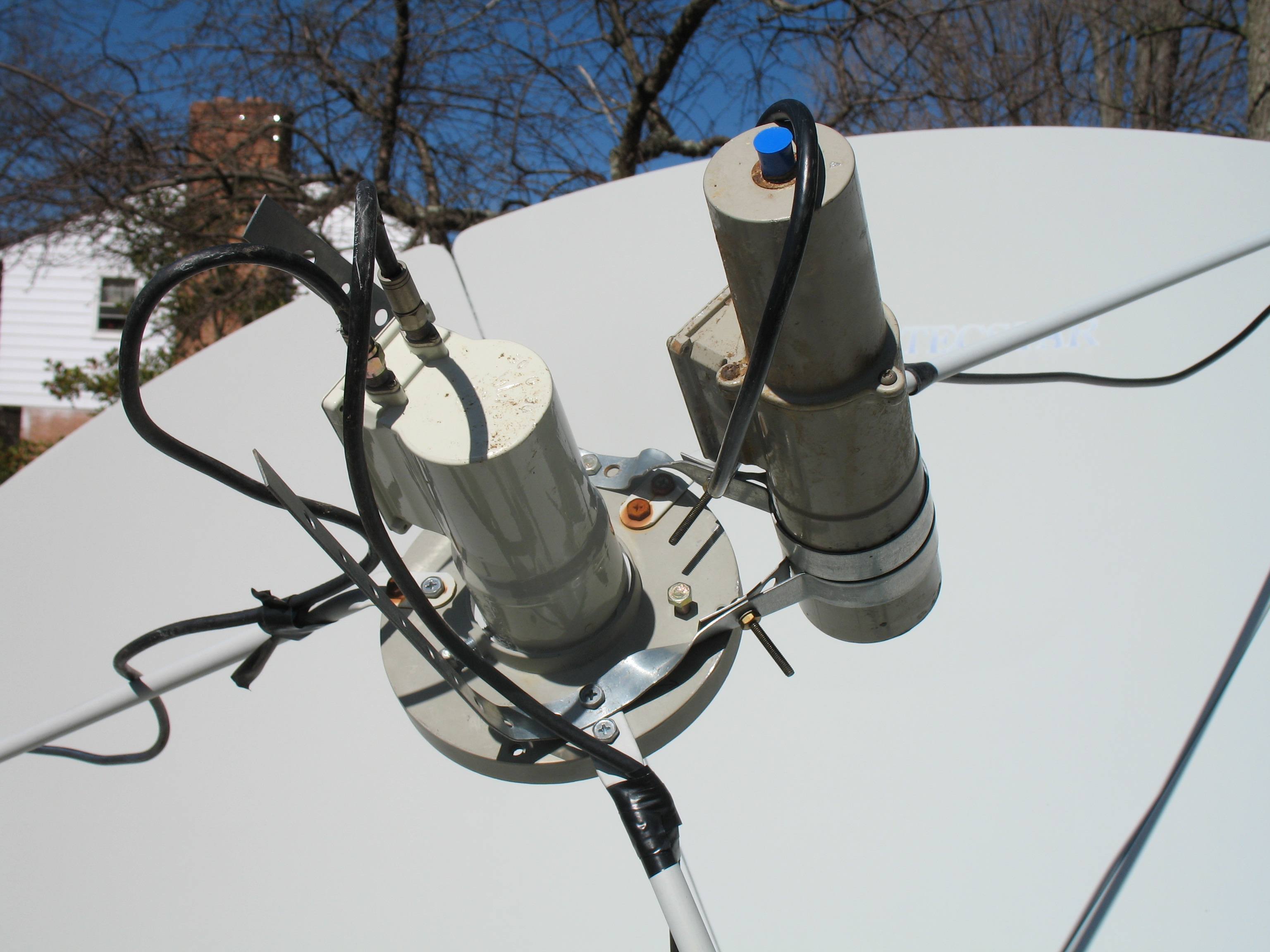

I have success using an offset C/Ku-band LNBF to receive 4DTV from W5 @ 105W on my stationary dish aimed at 99W. I mounted the LNBF using 2" pipe hangers, planning to mount the LNBF using a scalar when I had the position maximized. The results are good and the reception is perfectly acceptable. Previously I used my 10' BUD for 4DTV and my EB# was +12.0 and Quality of 99 on the 4DTV receiver. Using the offset, the EB# is +9.2 and Quality is 88. This releases my BUD for FTA use across the arc. Perhaps later, I will remount using a scalar to see if there is any difference. The main LNBF is a Geosat Pro Dual C-band.
View attachment 74740View attachment 74741View attachment 74742

My dish is not offset, it is prime focus and 2.4 meter size (8 foot). The LNBF is offset from the main focal point to obtain the reflection of the 105W signal. I think a lot of my success is due to the 2.4 meter size, since the beamwidth is more narrow with the larger size dish. The positioning of the offset LNBF to obtain the 6 degree difference between satellites would be, I expect, more difficult to achieve with a smaller dish.
