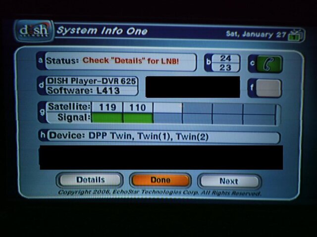

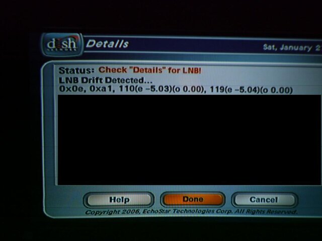

I have the same problem with my 625 DVR....
Here's a picture of the TV screen with the LNB Drift Detected details....
I have a Dish 500 plus...

Well, I have the same thing since this update. So, are you saying all of our 61.5 lnbs have gone bad? Don't think so.
Here's the scoop on the LNB Drift detection -
As RandallA said it's part of the diagnostic software finally being utilized.
If your drift detection is within +/- 5MHz that is fine. If it's outside of those numbers it's time to replace your LNB.
If you show +/- 12MHz do not replace the LNB, it's a bug in the software.
To my understanding this is to detect a future failing feedhorn.
Not all IRD recieved this update. I know the 625, possibly 322. This is just the beginning of the diagnostic software.
