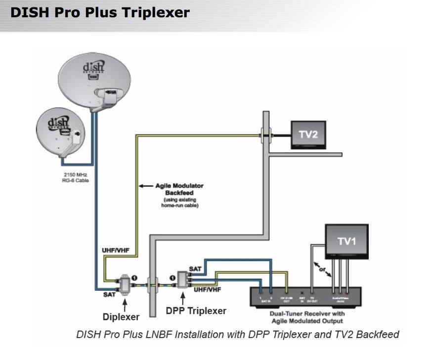

So I checked the cable on the back of the receiver (home distribution port). Where should this cable be going? Right now, it goes directly back into the triplexer that the two outputs go to. So the triplexer has an input from the wall outlet, 2 outputs to the receiver, and the home distribution port goes to the third spot labeled (antennae 'optional'/ch. 21-69) Is this wired correctly?
Yes, it's wired correctly. The TV2 signal is "backfed" using a triplexer, and diplexer. Somewhere else in your install will be the diplexer which has the cable that goes straight to your TV2
