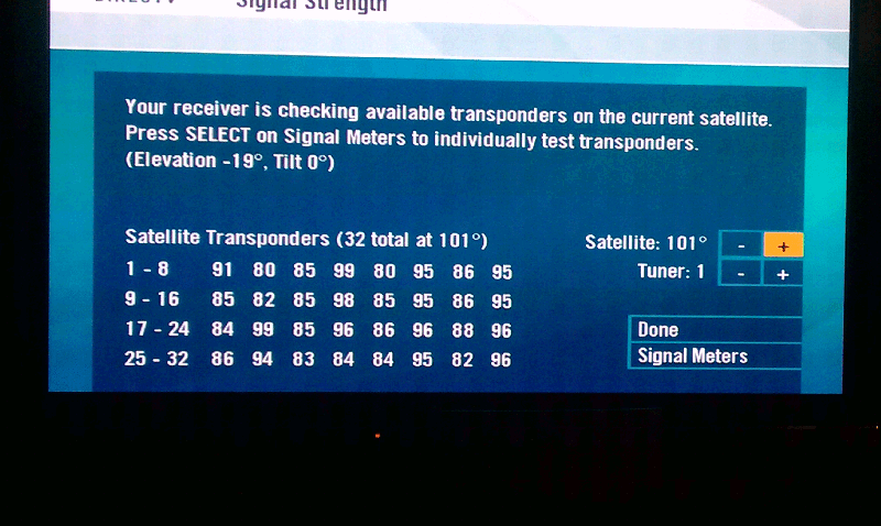

I know the old system doesn't have swm and it is not connected to the internet. The fact that it worked showed me there wasn't some kind of signal problem. I have had the tivo dish in the same place for 10 years, nothing between it and the sky, very high signal. My new dish is right under the tivo dish, very high signal as well. My question is what does the swm have to do with the internet connection since resetting the network equipment seems to correct the 771a problem. If it happens again I am just going to reset the network equipment and not touch anything else to see what happens. Hopefully it doesn't happen again though. I wish I would have thought to try the network equipment reset in the first place.
