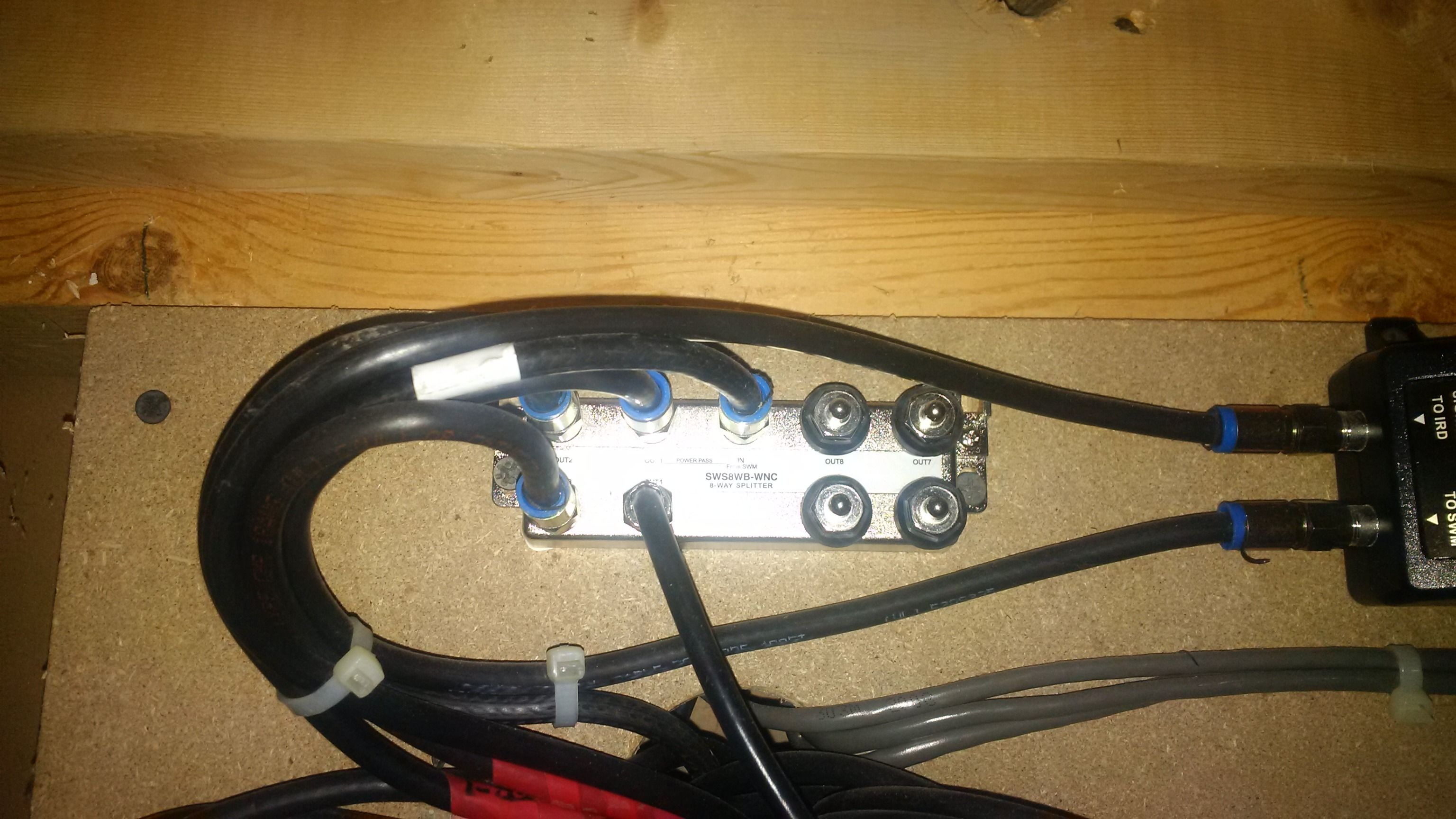

I'm using a 8 port switch for distribution cables to rooms, my dish is a SWM5, one wire comes down to the 8-way switch from roof.

Are the unused ports on the splitter (assuming you meant splitter and not switch) terminated. Either way, have you tried using other ports?
There are unused ports, I haven't tried using other ports yet, is that a common problem / solution?
I'm not sure if they are terminated, they have these rubber thing on them, here is a picture.
Those are terminators with rubber boots. You might try a different port, one of them could be bad.
