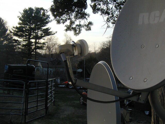

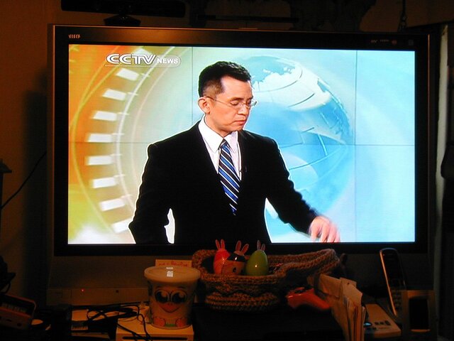

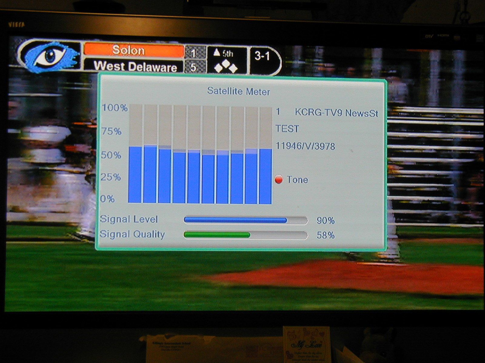

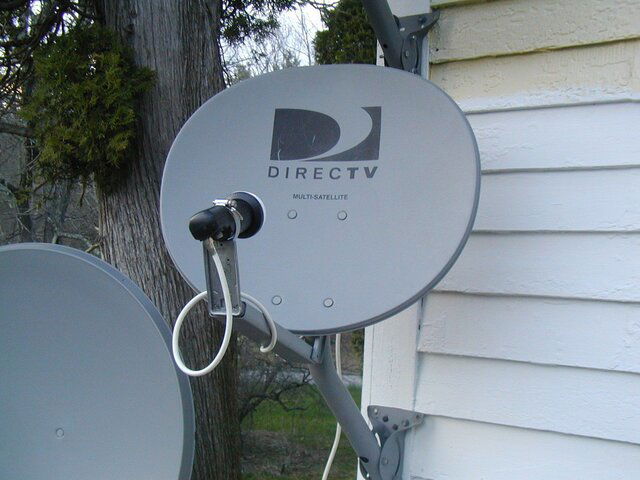

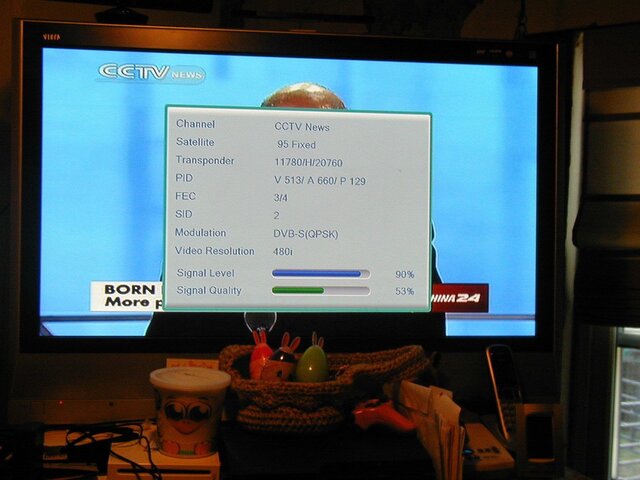

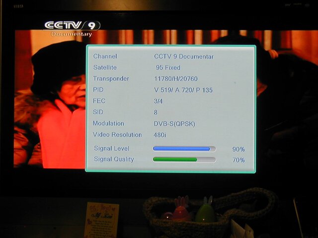

I've been messing with a small 18'' pizza dish that I have here for the last week or so and finally was able to get 95W to come in watchable on it, figured I'd post it because the way I finally did it might save someone a few headaches if they try it.

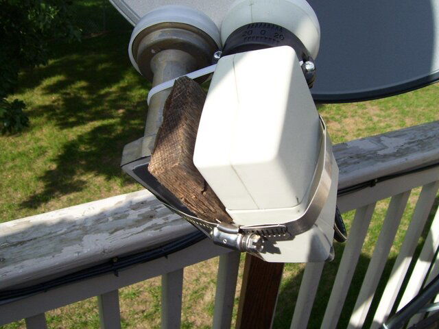

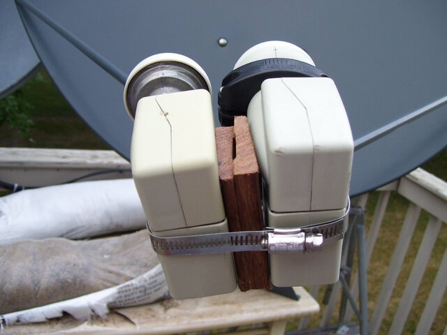

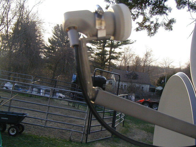

I'd first tried one of those universal LNB holders and then made a holder, but neither of them worked very well, I could lock transponders but not get any viewable picture. What I ended up finally doing was removing the plastic housing of the original LNB that was with the dish and the circuit board and then chopped off the round end of the feed. I then chopped off a little more than half of the wave guide and then just hose clamped a cheap universal to it. It actually seems to be working okay, quality on the MIcroHD is between 49% and 58%, of course, it's nice and clear today, in lousy weather it'll probably be a different story!

I did this experiment a couple years ago. What I also found besides what you posted was to move out about an inch more to get a better signal.
Thanks for the tip, Ke4est. I'll try knocking a little more off the front of what's left of the waveguide, to give me more room to move forward and back. The way it is now, I can only go forward and back maybe a quarter of an inch, if that. I tried getting it to sit about the way the original LNB did, maybe I can get a little better quality if I can get it back that inch or so!
Changed out the reflector to an oval shaped one I had here and now the signal is holding between 60% to 63%. I'd post a picture, but it started raining here. Maybe tomorrow.

Today it was overcast and raining, the quality is much lower. This morning at six it was pouring out, the quality was bouncing around in the 40's and the picture wasn't watchable, right now it's still heavily overcast and lightly raining, the quality is 49% to 53% and picture is breaking up a little. Guess it'll only be a fair weather dish. :D

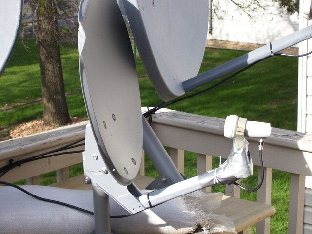

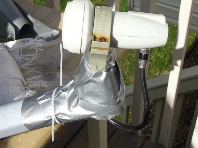

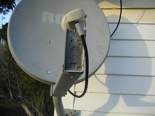

I did the 18" dish on 95W many moons ago...when I had a real crappy camera. Being almost dead south of the satellite helped :)

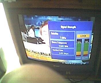

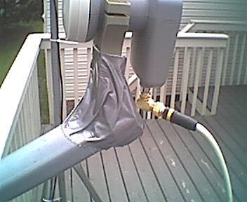

Also did that for 72W for the NBC feeds

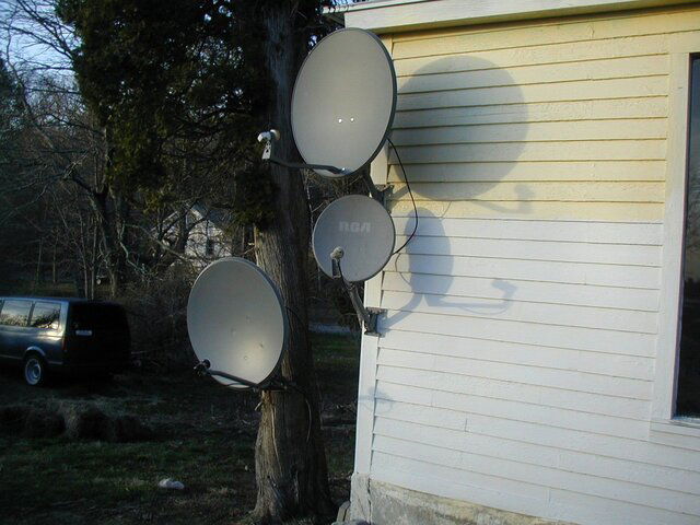

Before I got a motor for my main dish (at 97W with side LNBs for 91W and 103W), I had an 18" dish pointed at 72W. Since I'm at 76W, it was easy to move it as far as 79W by only changing the azimuth. 79W never worked too good though, as it was an old satellite. 74W on the other hand was great, as it had a spotbeam option that really lit up the east coast when they used it. I watched Anderson Cooper covering the Haitian earthquake on that dish, every bit as strong as if I had had a proper dish on it.

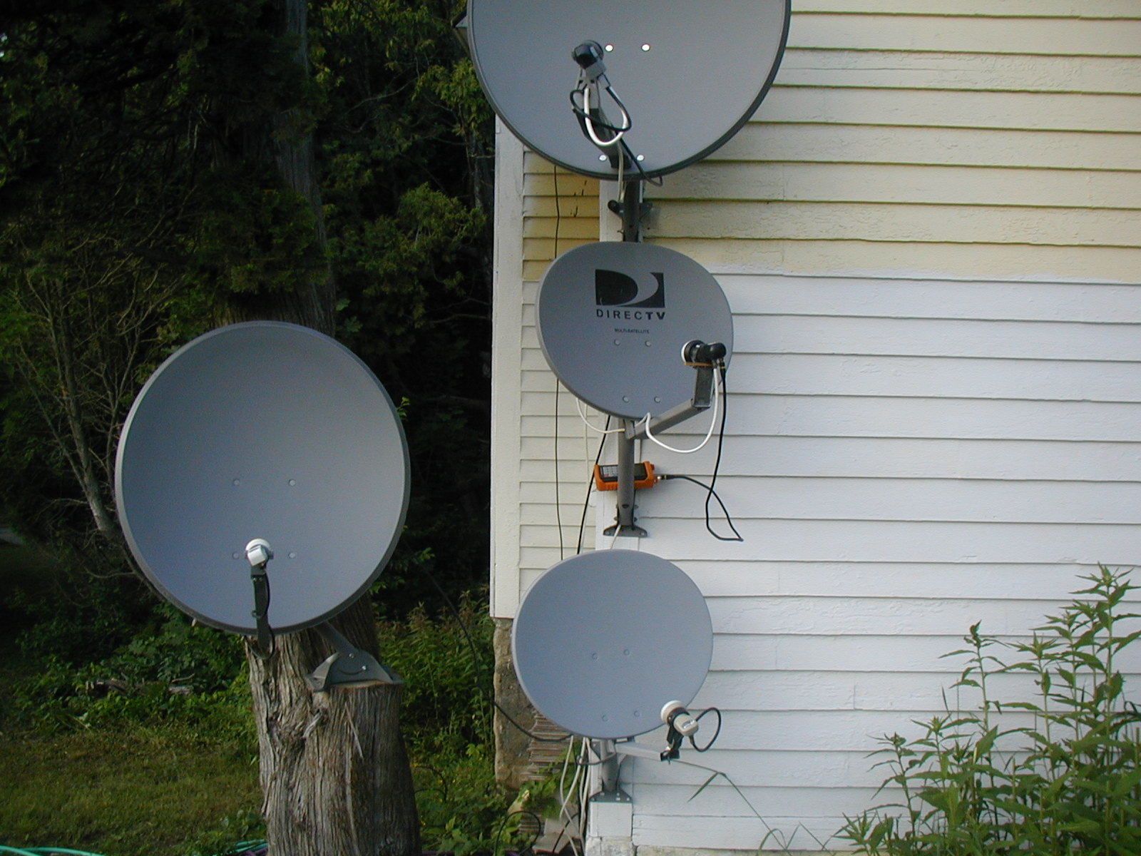

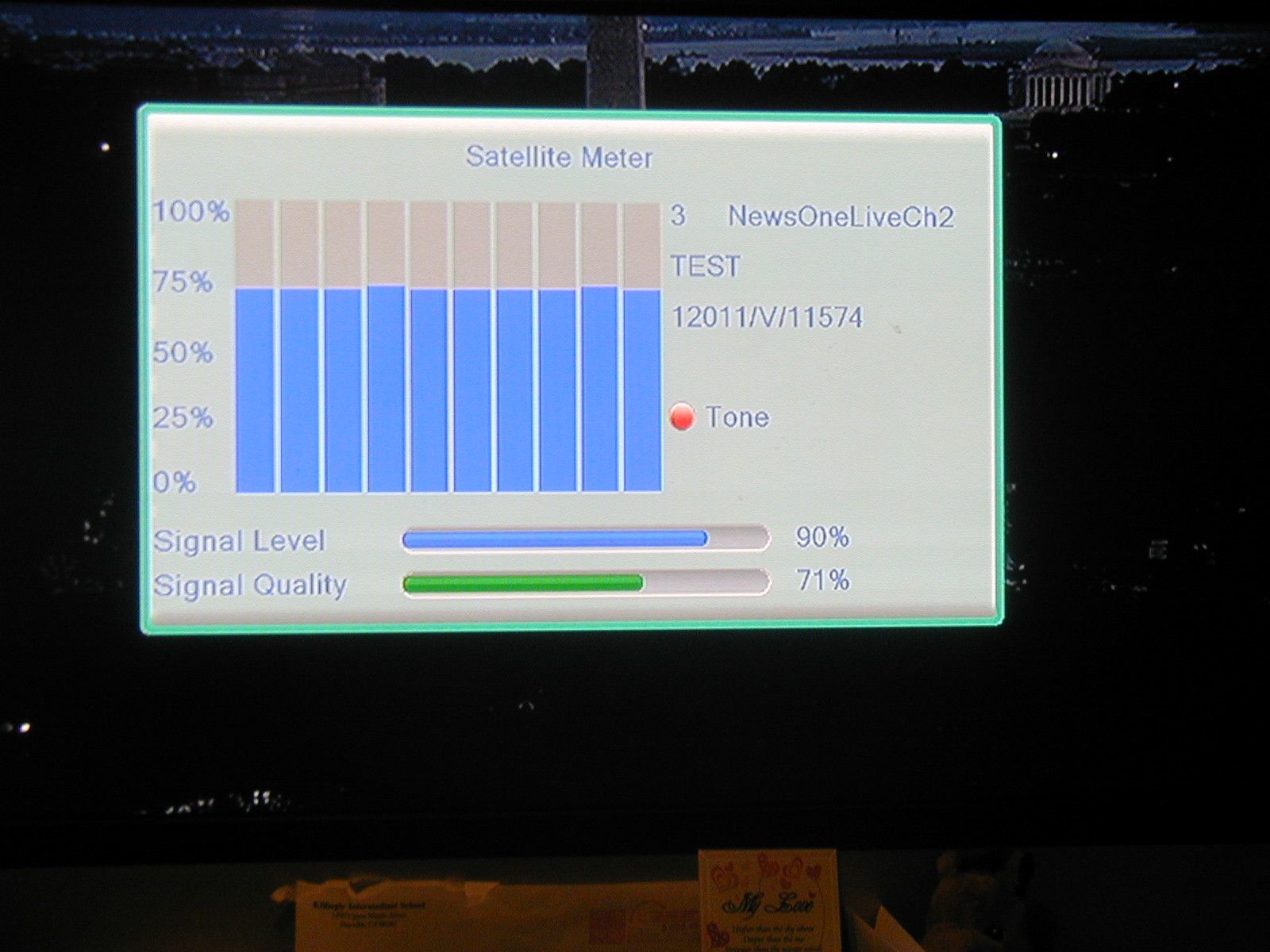

Finally felt well enough to go out and mess with my dishes today. Changed out the reflector for a slightly larger one and slapped on an Avenger PLL, hacked off a little more of the LNB mount so I could move it back a bit like Ke4est suggested and now the quality is staying right around between 67% and 71.
