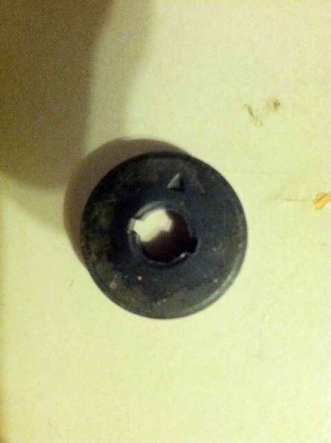

first this is from an old SuperJack II+ actuator that is broken so its my parts actuator ( motor is bad but i can use it to get the ideas and placement ) i have the twin actuator out on my 7 1/2 ft unimesh dish .
first the Superjack II+ has one sensor and a magnet wheel with a arrow/ triangle pointing to where its magnetized ( where it activates the sensor).
second i can't remember (but i will double check when i can) but i think this actuator has a 32 count per inch
layout of the sensors ( i first planned to add 3 additional sensors for a total of 4 X 32 counts = 128 but space being limited inside the area around the magnet wheel i probably can only get 3 . I also thought that 2 or 4 sensors would be equally spaced so going with 3 sensors i would probably have to evenly space the sensors so i would get an accurate count both ways.
old motor
magnet wheel
three sensors
thoughts and comments welcome , i don't know how long this project will take but basically walking through it now :)

I can't see where the poles are on that particular magnet so some investigative work would be in order.
yes i can see your point ... and thats what was being discussed in the other thread where magnets were added from 4 to 8 or 10 to a plastic / nylon wheel
this particular actuator has a wheel that the whole thing is a magnet but only has one pole marked with a arrow / triangle i thought this was the area where the magnet was the strongest and activated the sensor.
It's been a while since I've played with them, but think there are more than one place about those, that will activate the sensor switch.
But if it is only one active region, should be able to place as many positions around the thing as you like. Could confirm it with small lights or LED's. See that only one switch is on at a time as the magnet rotates.
