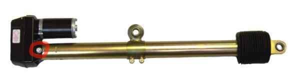

There should be 2 bolts at the base of the arm, see Pic
Okay do I need to twist it or does it just come off? Can this arm be greased still connected to the dish or does the actuator have to come off?

1st remove actuator off dish
2nd remove the 2 bolts an the end of the motor like lak7 posted.
3rd outer tube will slide off with its back mount for the dish, an the motor an pusher tube will still be together.
4th measure the inner tube to a reference on the motor, you will need to reset it back to the same measurement.
5th start un screwing the pusher tube DO NOT UNSCREW all the way little balls will fall out, an if they do, its VERY time consuming to get them back in place, tweezers an grease if this happens.
6th clean an grease, found that wd-40 is a good cleaner with lots of rags
7th reinstall back in reverse order.
