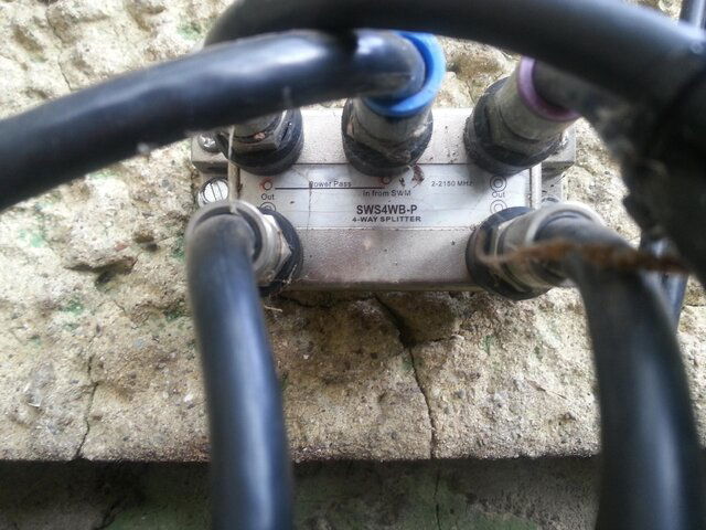

Heres the splitter. The "In From SWM" port is the cord running from the dish. The "Power Pass Out" is running into the basement into the power inserter, then directly out of that into the receiver. The other 3 outputs are currently run to other rooms, but are currently unused due to remodeling.

Aside from the fact that that particular model splitter is older than dirt in the terms of swm technology, everything looks fine, what I suspect you are doing wrong is running the line to the garage into the wrong port of the splitter. You MUST leave the power passing port running to the basement, and into the power inserter and to that receiver alone. It must stay connected as is. You can then use any of the other three to run to the garage. Or swap the splitter to an 8way and keep everything hooked up. Then make sure the receiver is indeed swm compatible. If it is a hd dvr combo, it must be model HR2X. The last number doesnt matter, as long as it starts with a 2. Hook your line up to the sat1 port on the dvr. When you turn on the dvr for the first time, if it was not origionally set up for swm, it must be reconfigured. Let it start up and then when you get to step 2 of 2, its going to freeze at 0%. Hit exit on your remote, then menu. Go to repeat sat setup, and hit dash or the up/down button on the front panel to proceed. The setup should be either 17 (slimline3s) or 18 (slimline5s) and it should autodetect the proper one as well. Hit continue and you should be in busisness.
Side edit, if one of the boxes is being moved from a room where it is currently working to the garage it should not need to be reconfigured.
I'm oversimplifying as usual but the solution seems quite easy. You say you are not using the other 3 boxes due to remodeling.
1 Find out which lug goes to room B ( IE: take each one off until you lose signal in room B) which is not being used.
2 Run your new cable from Room B's lug to the "man cave"
3 Take the box you are not using in room B and put it in the garage making sure you hook it up the exact same way it was hooked up when it was working in room b
4 sit back and enjoy the game.
I Think I found the issue! I ran the cable back to the garage, and tried again using suggested methods posted here, but to no avail. So I tested continuity on the cord again and there was none. So I removed the cable and inspected for breaks or anything that could have damaged it. The run consists of two cords tied into one with the equivalent of a butt connector for coax. I took it apart and tested each run of cable, and they both were good. The piece used to connect the two cables was bad. I picked up a new one and am setting it all up again right now. I'll let you all know if it works!
You are getting close,
Inspect both cable fittings, replace the barrel connector, and test. If it works AND you intend to put this underground do this: get a three inch long piece of garden hose or3/4 " pvc pipe. Disconnect a fitting from the connector and slide the hose or pipe on the cable. Reconnect everything and slide the pipe over the fittings and connector. Pump the hose (or pipe) full of caulking. The silicone caulk that is used to seal holes is fine. Pump until you are sure the whole thing is full.
