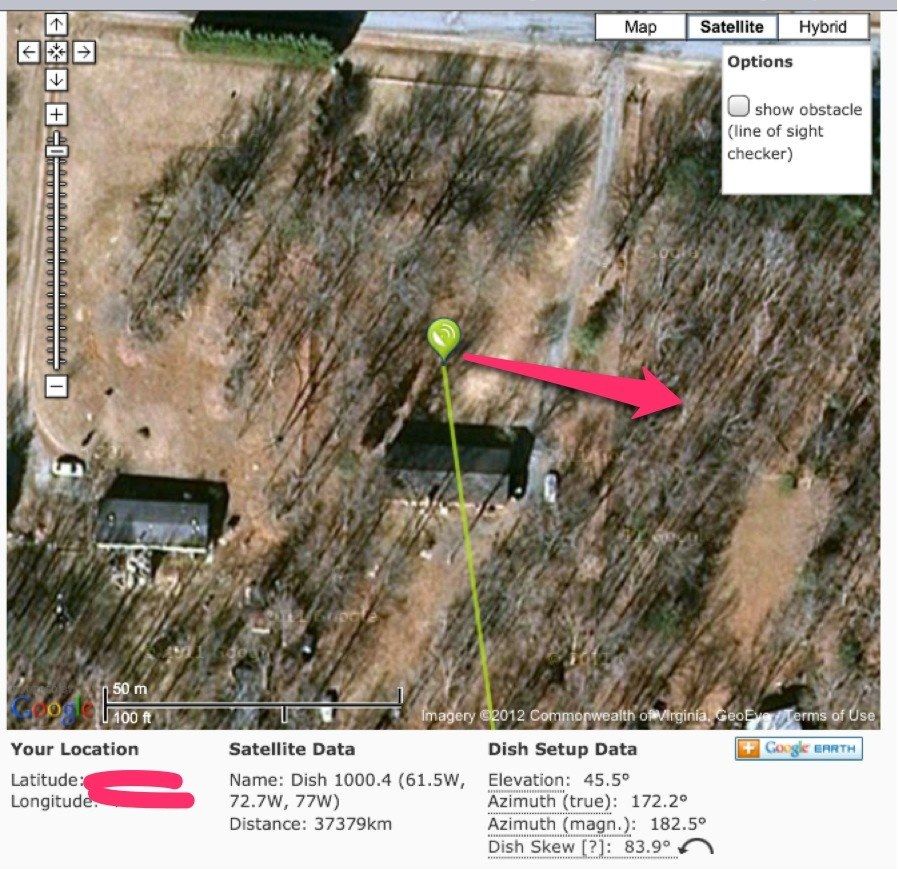

So, I followed the helpful advice posted here and went back to Dish Pointer. Sure enough, I do not appear to have my new dish pointed in the proper direction at all. Please see the pic below (sorry for the size). Umm...never mind. I cannot upload a pic from my iPad. The option to add the pic is grayed out. Ok...so the line for the satellite shown by Dish Pointer points due North, right through my house (our dish is located in our front yard and Dish Pointer points to our back yard). Our dish is actually aimed due west. It was pointed to the north before the Hopper install, but the service guy moved and re-aimed it when he installed the Hoppers. How am I getting a signal at all if the dish is pointed 90 degrees off of where Dish Pointer indicates the satellites are located? Please excuse me if this a dumb question. I am just interested to learn.
OK, I got off my lazy butt and got on the PC to add the photo I mentioned above:
The red arrow shows where the dish is now pointed and the green line shows where Dish Pointer says my satellites are.
Replied to the PM... So your receiver is saying that you're on a 1000.4 pointed at 61.5/72.7/77? My guess is that you're actually looking at 110/119/129. Either on a 1000.2 or a 1000.4 WA.
Sent from my iPhone 4S using SatelliteGuys
Oh by the way the sats are to the southwest or the southeast depending on your location and which arc you are pointed at. From VA the WA (Western Arc 110/119/129) is southwest and the EA (Eastern Arc 61.5/72.7/77) is south-southeast.
Yep, the receiver says 1000.4 on 61.5, 72.7, 77. Oh, and I got it backwards. The front of our yard is north and the back is south, so the satellites on Dish Pointer are showing to the south and the dish in my yard is aimed to the east/slightly southeast. Crap! Why can't we edit older posts?
Yep EA sats are to the south-southeast from VA so it makes sense that something was backwards since the arrow you drew was actually farther east than the EA sats according to the dish pointer site. The WA sats would be to the west.
