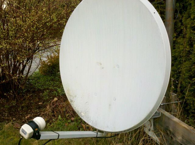

Got a bit of fine tuning to do. Am I correct in saying that the lnb has to point at the deepest part of an offset dish?

It's an older type starchoice dish. (not the oval type). The arms and lnb holder are still in place but the lnb i have is loose in the holder so i'm not exactly sure but i figure it should point at deepest part of dish?

No, Star Choice (now Shaw Direct) is a service provider here in Canada. Their original dishes were standard offset dishes "round" (really oval). Once they started broadcasting on two satellites they became elliptical dishes (which scarecrovv means by saying oval).
images
like this one but the original lnb packed it in and my other one doesn't fit the holder properly.

That is usual offset dish. Where is the problem then? Measure the dish and use program like "Parabola Calculator 2.0" to calculate position of focal point. When you know position of focal point, make feedarms and LNB holder in such a way that LNB's phace center is located in antenna's focal point.
Than I do not understand something: why should you buy new LNB as it will be pointed at exactly same point on antenna surface as old one?! I think you should do something with LNB-holder or feedarms, not LNB.

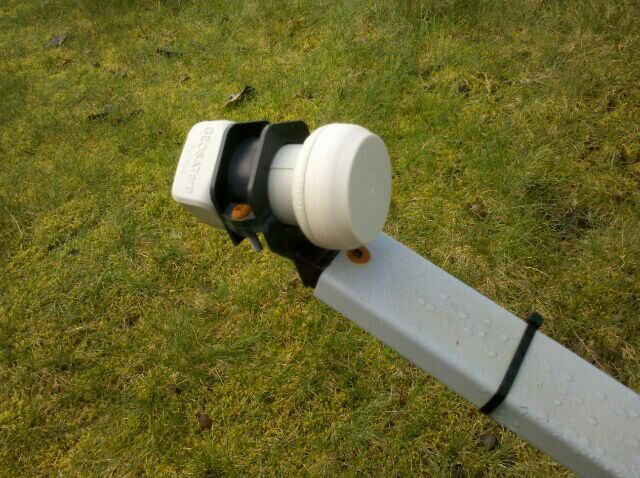

The original lnb is shot.....I have a different lnb......The original lnb holder and original lnb are an odd size....my other lnb does not fit the original lnb holder properly. I am going to order another lnb like the original and then it will fit the original holder.

I'm curious as to how the "lnbf doesn't fit the holder'? What make model lnbf is being replaced? What make model is replacing it? Pictures??
If the neck of the new is small, clamp too large, should be able to cut some plastic pipe to shim it.

One clamp size was for the "pop can" LNBF. I think the clamp size was 50mm. Another clamp size was for the 23mm mounts. They also manufactured a shim kit for the 50mm to clamp 40 and 23mm LNBFs, or you could use a split PVC pipe for clamping the smaller 40mm LNBF.

Exactly! It has the 50mm with an adapter for 23mm but my lnb is 40mm. I will try the pvc pipe. That sounds like a good fix.
