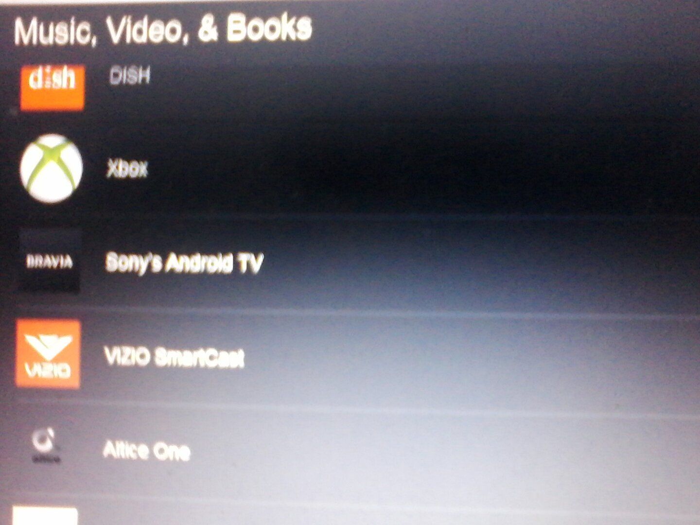

Another problem I ran into when I was trying to get this to work for my Dish receivers is that there is actually more than one Dish skill. There is the skill with the familiar old Dish logo, that you would expect to be the correct skill:

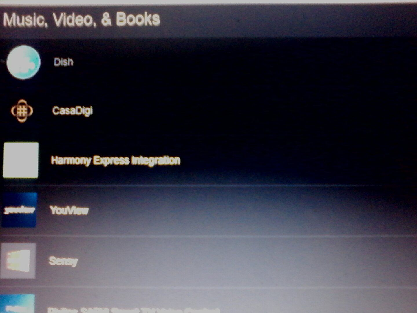

But then, much farther down on the list, there is also a Dish skill with a puzzle-piece logo:
In a desperate attempt to get Alexa to work, I tried Enabling and/or Disabling both of those skills. The result was that it confused Alexa even more. Whenever I would give Alexa a command, she would respond "I can do that on Dish or Dish. Which would you like?" If I did not answer the question, Alexa would just repeat it. Of course, even if I answered the question, Alexa still would not actually control my receiver, no matter how I tried to say "Dish." At one point, Alexa was so confused that she was apparently listing three Dish skills, even though there are only two to choose from in the list. ("I can do that on Dish, Dish, or Dish. Which would you like?")
