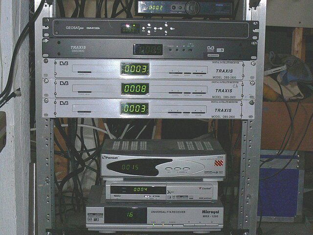

Came in today and just to let you know that they work great and all three are now mount in my rack. Found that all had bad capacitors on both the power supply and mainboard other than no issues as everything can be programed by using the front panel buttons and only took a few minutes to it figure out.

Yes, the Main board 1000uf 10v capacitors are bulged or leaking.
No, the Power supply 2200uf 10v capacitors are not bulged or leaking.
I've got a Sencore LC53 capacitor tester that I used to check the one that wasn't bulged and they tested good but I went ahead and replaced them just because of the age and since I already had them open. If you replace them now then you know there won't be a problem down the road.
Failing capacitors is actually a major defect with these Traxis receivers. We had to replace over a hundred Traxis rack mount units within the first year and a half of service. The distributor wouldn't cover the repairs or shipping, so we stock piled in excess of 200 failed units and set to a local recycler.
