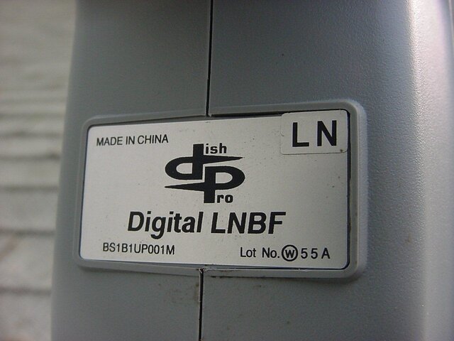

part number
We just got a batch in and they were the same part number as a normal dp dual.
But they have a "LN" label above the "DP" on the label. Will let you know when we get some more if they have a new part number.
I have noticed a gain of 10 in the point dish screen after putting in the new LNB.
If it helps they are the same lnb's used in Alaska and Hawaii.

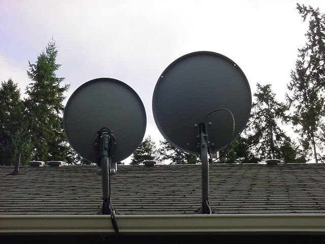

Fellas,
Here are a couple of photos of my setup. One is the Low Noise LNB and the other is the larger dish, shown next to the standard Dish500.

For anyone who didn't already find out, here is what Claude at DishStore had to say:
Claude said:
I actually got some in stock, they are $10 more than the standard
Dishpro Dual LNB's
For all intents and purposes they look the same, but I did not test
them to see if there is a difference.
Claude G.
How do you go about getting the bigger dish? Last time I called tech support they knew nothing of it. What kinds of charges are involved?
cebbigh,
I got the bigger dish when I did the upgrade to the VIP622, including installation. It did not cost anything (beyond the $199 lease) for the new dish. I did have a Dish 500 with I bracket already aimed at the 129 bird, but the installer (DNSC) said their marching orders were to install the larger dish for 129 or a standard dish for 61.5.
