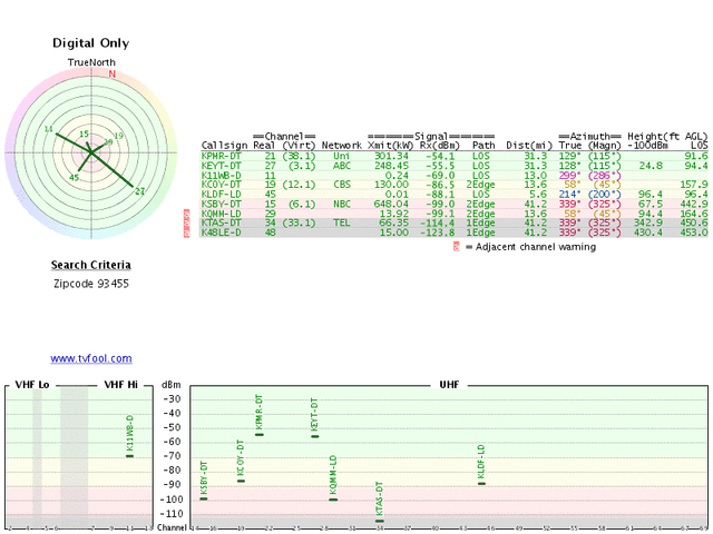

The way to get the cleanest signal for all the channels is to use a rotator. With a good directional antenna like the Channel Master 4228, you'll probably have an easy time getting all three networks (ABC, CBS, and NBC). The only caveat is that you can't receive all of them at the same time.
The Square Shooter is not nearly as good as the 4228, so it's harder to say whether it's good enough the pull in the weaker signals.
The attached TV Fool analysis for your zip code shows the relative signal strengths of the channels reaching your area. This is only used as a rough example, and you should definitely get your own analysis with your exact location for more accurate results. Pay attention to whether or not your location has a line-of-sight or a 1- or 2-edge diffraction view of each of the transmitters.
