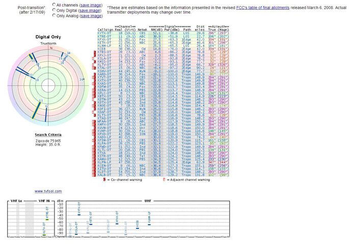

Do you have any type of antenna now? Here is your local DTV chart. How tall and how close are those trees? I think a CM4228 might work OK mounted just above the roof line. There is a beam width of 129 deg so that might be tough without a rotor or dual antenna setup.

Only 30 miles to 19.1 you should get it fairly easily with a UHF antenna.
ABC on channel 9 is strong too.
I would get a Winegard HD7694P and a rotator.
