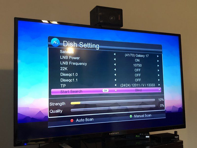

Hooked up the new X2 M1 HD+ I received today. Connected it directly to 91. Not getting any signal whatsoever. Wondering if I'm doing something wrong or if box is a dud. I verified signal strength and quality on both my Amiko receivers just to make sure I wasn't crazy; they both pull signal down the same coax just fine.
I'm thinking it might be a dud since both Amiko's work fine when connected to the same line

As a test, remove any DISEQC switches, connect to a LNB, and select the strongest TP on that bird. If it doesn't work, then you've got a dud. I would contact the seller then.

Do you have a switch connected to it? In your picture the DISEqC settings are off.

PS- on the question of the switch, I've been direct-connecting the LNB to the receiver for testing and bypassing the switch
Will also check output voltage tonight.
