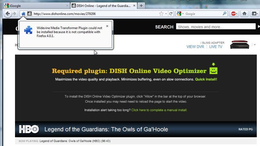

I'm wondering too .. I've got 4.0.1 and it still says it won't install the DRM add on from Widevine .. funny.. widevine is a google company and there is no phone number listed on their web site to call them to find out when they will release an update.. or if they already have, and maybe dish isn't getting it..

Dish Online's main experience isn't from LiveTV/DVR ... much of the "DishOnline" experience is either Hulu based, or premium "subscriptionized" content, Epix, HBO, etc.. its the content that comes from those sites that has the problem with Widevine Media Transformer (or DRM by another name) and Firefox 4..
For me.. I've never had problems with FF4 and DishOnline doing LiveTV, or DVR'd items.. and initially I didn't have problems watching other content.. but then someone at D.O. turned on this supposed "optimizer" and ever since I've been unable to get any of that other content (going on 2 months now) and also with no response from "feedback" ...

On the main page ... the "rotating banner" shows The Legend of the Gaurdians - Owls of Ga'Houl .. its an HBO tie in, so you'd have to have HBO to get it ... and of course this plugin isn't required if you use HBO Go for the same content.
It was required last night for Starz content (Toy Story 3) and it seems now that Epix stuff is coming through without requiring it .. perhaps the Epix content was cleared or there was some odd caching going on ... because now I can get three different epix titles I tried. HBO & Starz tested this morning are still causing the prompt for the other plugin.
Also just tried "Class" a PixL content provider, it required the plugin, also tried "Diary of a Whimpy Kid" from Cinemax and it too went backto the "plugin" installation screen. Other channel content IFC & Sundance went to the "play" screen (graphic from movie with playbutton visible)
attached: screen shot of the pop-up/alert

Ahh, now I see. I tried "Class" and saw the plug-in issue. Thanks!
yup... and now that adds even more fuel to my rage that DishOnline appears to have come out of beta and *STILL* this issue exists.. TWO MONTHS after I frist reported it..

Update !! New plugin just downloaded to FF4 (32 bit) on Vista !! YAY!! only 2 and a half months later! and finally can use the other parts of DishOnline.com ...
Just discovered what was probably my problem: the Stop Autoplay extension. Turning this off allows, apparently, everything to play.
