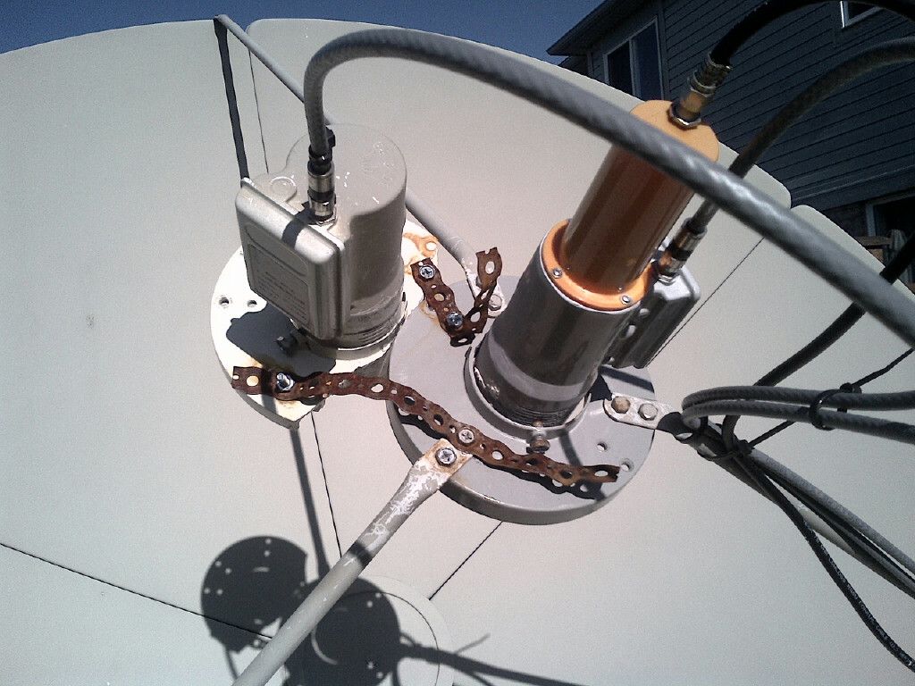

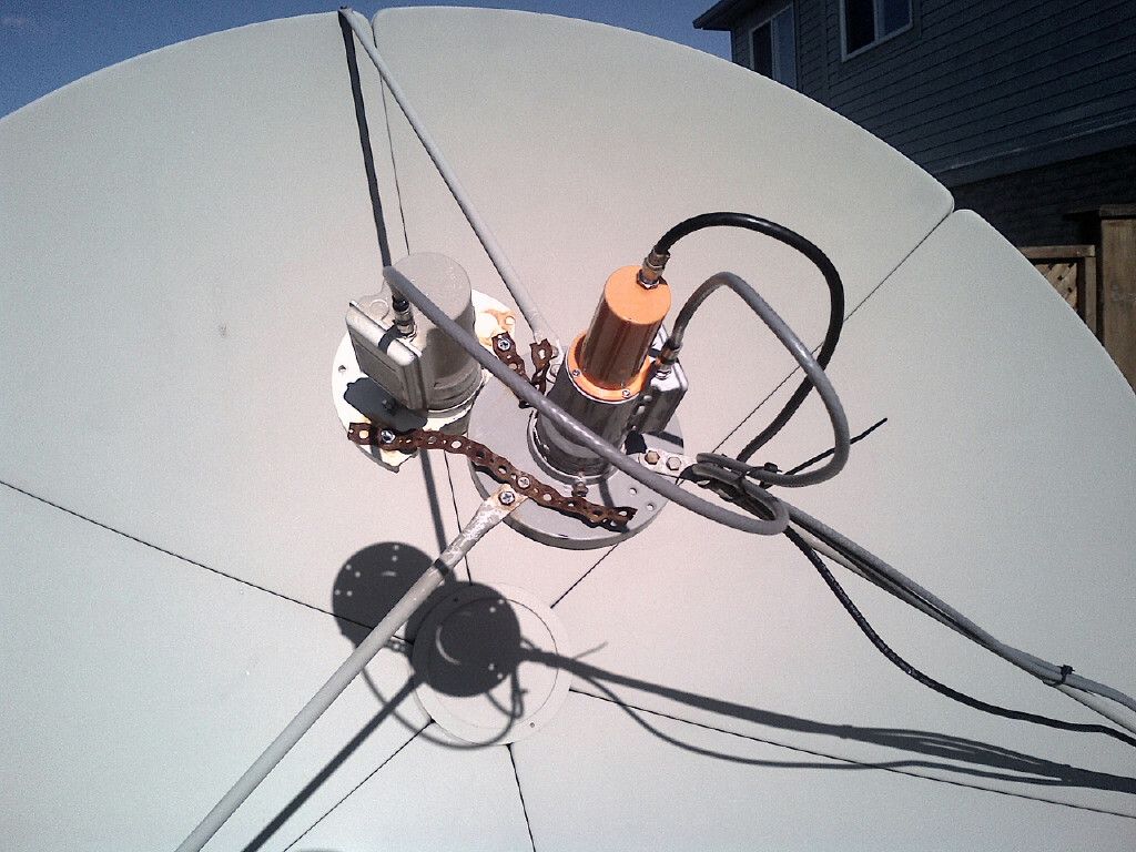

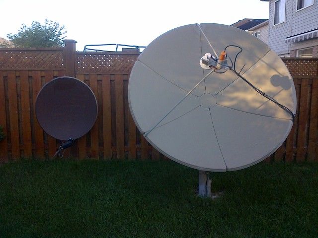

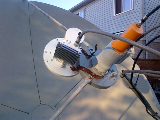

I have placed such information in various occasions; I do have a Fortec 6 ft dish with two LNBs, linear in the central focus (Ku+c)and circular just placed aside of the linear. I receive more than 100 chs, I would say most of the open channels available. Everything is working well here even the Ku band on the dual band LNB. The picture is one year old, I replaced in Fall 2013 the circular with the new Titanium C1 PLL and changed the crappy scalar ring with a new one with more surface around the central ring, which improved the overall reception. The dual band LNB is the BSC-621.

I found some more recent pictures (June 2014) with the Titanium C1 PLL on circular mode, the BSC-621 dual band as the linear LNB and a full scalar ring for the circular to better illustrate the existing set up. Hope it helps.

View attachment 101255 View attachment 101256 Hi Andrew.

Converting the Linear LNB to circular is quite easy, just insert the reactangular isolator included wit the LNB inside exactly between the two small metal pins (which are the antennas, one is the V and the other the H) and now you have a circular polarized LNB as can be seen below.
