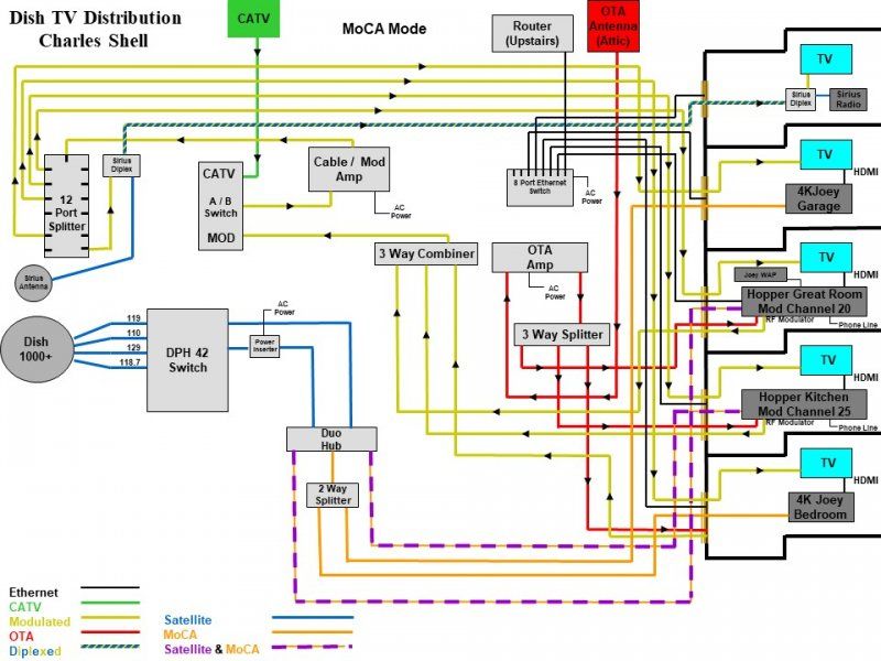

Here is my two Hopper 3 system with one dish and it works great.
View attachment 128558 View attachment 128559
Nope, pure red neck. Self taughted or learned. Whatever that there correct word is.So you're an engineer? LOL that is a hell of a drawing
It does not have a brand name on it but it looks identical to this one.Charles, what brand and kind of A/B switch is that?
It's not supported and they say that over time it will fail but hey, if it's working, then go with itI am not sure if DISH supported because I am using a Duo Hub. But it works great.
Well, if it fails I have a spare one or change back over to two Solo Hubs. That is what the DISH technician installed with a jumper coax and then I changed it to the Duo Hub after he left.It's not supported and they say that over time it will fail but hey, if it's working, then go with it
I will fix it someday!What's with that diagonal wire? I thought you liked to do neat work?
It IS one hell of a drawing. That had to take some hours.So you're an engineer? LOL that is a hell of a drawing
You still haven't corrected the radius (bend) on the cable that goes above the duo hub !I will fix it someday!
Yep, very hard to make since I had never used power point before. Just started clicking.It IS one hell of a drawing. That had to take some hours.
See post #14.You still haven't corrected the radius (bend) on the cable that goes above the duo hub !![]()
Visio is your friend. I do these kind of diagrams regularly and Visio makes them soooooo much easier.Yep, very hard to make since I had never used power point before. Just started clicking.
