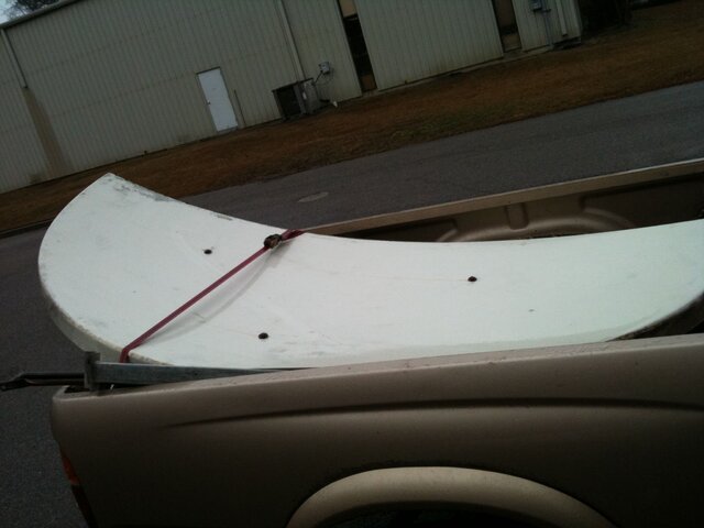

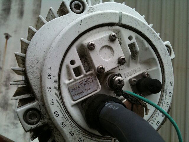

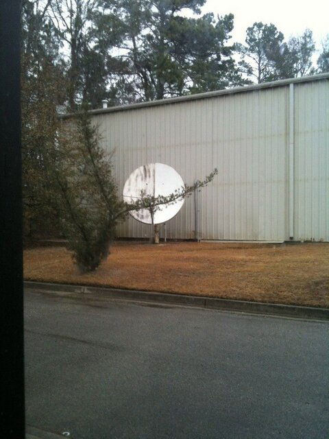

Got a question for all the BUD guys out there. The main thing I need to know is will this dish pick up Ku frequencies? I'd like to use it to pick up a DBS transponder just outside of the spot beam at a summer home. Anyway, I can have this dish for free but don't want to waste my time if its not adequate for the DBS frequencies. Here is what I have gathered by looking at it.
Appears to be for some type of VSAT application. Transmitter on the front is a Nextar C3575B. Its a 2 piece dish and on the back says 2.7m NS100317. Also, on the bottom half are the numbers 88656 and 88595 which I assume are the part numbers for each half.
Any help is greatly appreciated and thanks in advance!!
Oh, and P.S. This is a commercial style offset dish at an old warehouse if that matters at all. I figured anyone that knows what they are looking at would know this isn't a personal consumer type dish.

Man that'd be SUCH a waste for that purpose, but that's my opinion. But yeah I think that it should do what you want, no problem. Only issue would be how you would mount a DISH LNB to it, but once you have the dish you can figure that out. We'd need some pics of the feed assembly to make that determination.
And if it doesn't work...get in touch with me, I'll buy it from you...LOL
I'm pretty resourceful so I think the LNB mounting will be a piece of cake. Now, if you could please tell me how to explain to the wife that we need this dish in the back yard in addition to the 3 relatively 'small' ones. I actually thought it was around 6' until I got permission to remove it. Went in for a closer look and realized just how big it was.
There no second thoughts with that dish. Have you ever heard "It's easier to apologize than it is to ask permission"? :dev This is absolutely one of those occasions. That dish is just too cool not to have. Get it. GET IT! You need it for the Super Bowl! :)
An 8¾ foot molded VSAT dish?
Run, do not walk! - :up
The transmitter/receiver head looks similar to what you see on a bunch of 6' Prodelin dishes here on the forum.
We've even seen 'em on 1.2m (4') dishes, occasionally.
Get a few more pictures... those are tantalizing, but missing some proper views that would put the icing on the cake.
However, I have absolutely no use for that dish, but if offered, I'd go get it, just 'cause! - :cool:

I'll get a few more pictures of it on my lunch break. I've stared at the thing for 7 years out of my office window. Just finally decided to go inquire about it. I was actually wondering about putting a standard DP LNB on there myself or if I'd need a different style to make the best use of the dish's size.

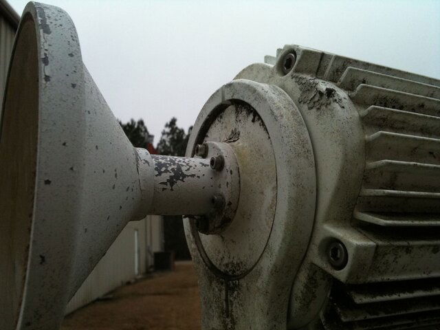

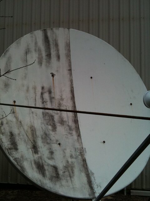

Ok guys. After further review and some additional pictures, here's what I have. Its actually labled 2.4m at the top of the dish. I thought it said 2.7m but I got a ladder out so I could get up there and see better. The dish is 2.4m wide and 2.7m top to bottom. The transmitter on the front is a 1.5W Nextar and it appears that the bolt pattern on the feed matches the stacked DBS LNBs that dish used for the 110 on the Type 2 superdish. Might be able to bolt one right on. Still unsure of the branding.

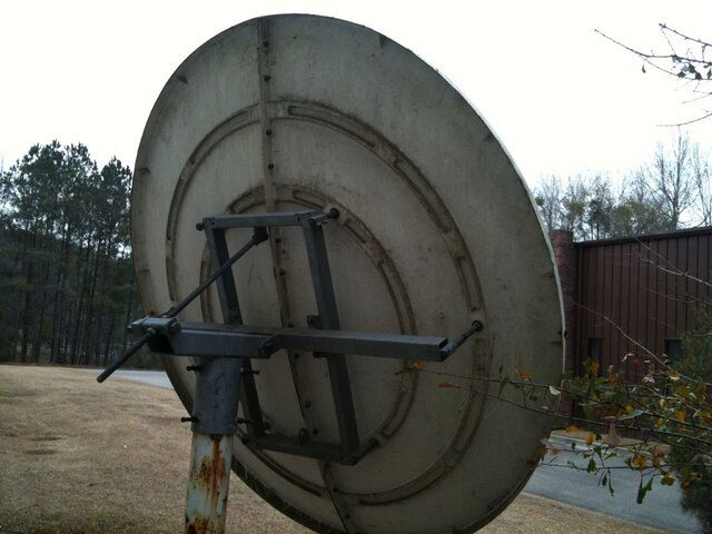

Well, I did a little more homework and I think I've answered my own question. lol It appears that its a Prodelin (Thanks to Anole for bringing up that name and steering me in the right direction :-) ) series 1251 C/Ku band receive/transmit dish with the ku band adapter already installed. Given that fact, I'm almost positive the mini stacked DBS LNB I have will indeed bolt right up. One other thing I'm curious about is the fact that there is no circular / linear spec listed for the Ku side. I assume thats irrelavant though as long as its capable of receiving those frequencies.
http://www.gdsatcom.com/Antennas/Data_Sheets/5002-355.pdf
http://www.gdsatcom.com/Prodelin/Technical_Docs/assembly_manuals/4096-476.pdf
Well, the transmitter is on one polarity (maybe H) and the receiver is on the opposite polarity.
And the adjustment in the mechanism is to rotate the head to line up with the satellite (skew).
If it were circular, no rotation would be offered (nor needed)
So, there's nothing circular about it.
The existing LNB for Ku is probably a decent NEC (branded on the head) and single polarity ('cause that's all ya need)
From reading the Pendragon thread on a similar project, I wouldn't bet the Dish bandstacked LNB would fit the feedhorn.
If it does, that's great. If not, somebody gets drilled and maybe tapped. ;)

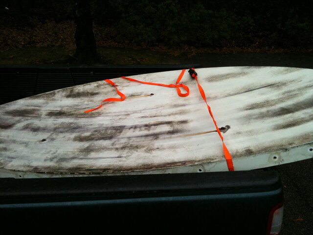

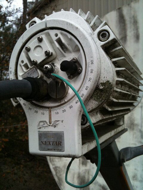

Ok. Assuming the rain holds off I should have the dish in my truck on my lunch break. Already took it about 1/2 way apart this morning. I'll have it on location this weekend. I'm hoping to rest it on the ground inverted and test that way before putting it on a pole. I've got a digisat II meter so aiming it should be easy even if I just rest it on some bricks for now. I'll let everyone know on the signal reading. Got my fingers crossed!
Well guys, she goes home with me today. Took the whole thing down on my lunch break and loaded it up. More to come later.

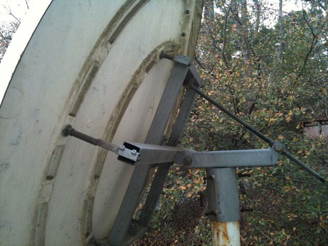

I'd look at the six holes through the middle of the dish where it mounts.
Also, the holes at the rim, where the LNB support arms attach.
Those are stress points. Just check for any cracking.
I'd get bigger fender washers and install them at all those locations, to spread the load as widely as possible.
That and a power wash on the way home, and you'll have a new dish! - ;)
Noted on the bolts, Anole. The dish is in absolute perfect condition as far as I can tell. Don't see any cracks at all. I'll give the thing a trial run this weekend and post an update on the signal strength for the transponder I'm looking for. If it works, I'll need to get another pole to mount it permanently. Unfotunately it was on a 6" pole where I took it down. Seems like serious overkill and I may change the collar on the mount to something smaller. I used to have a 10' Cband on a 4" pole and that was plenty adequate.
