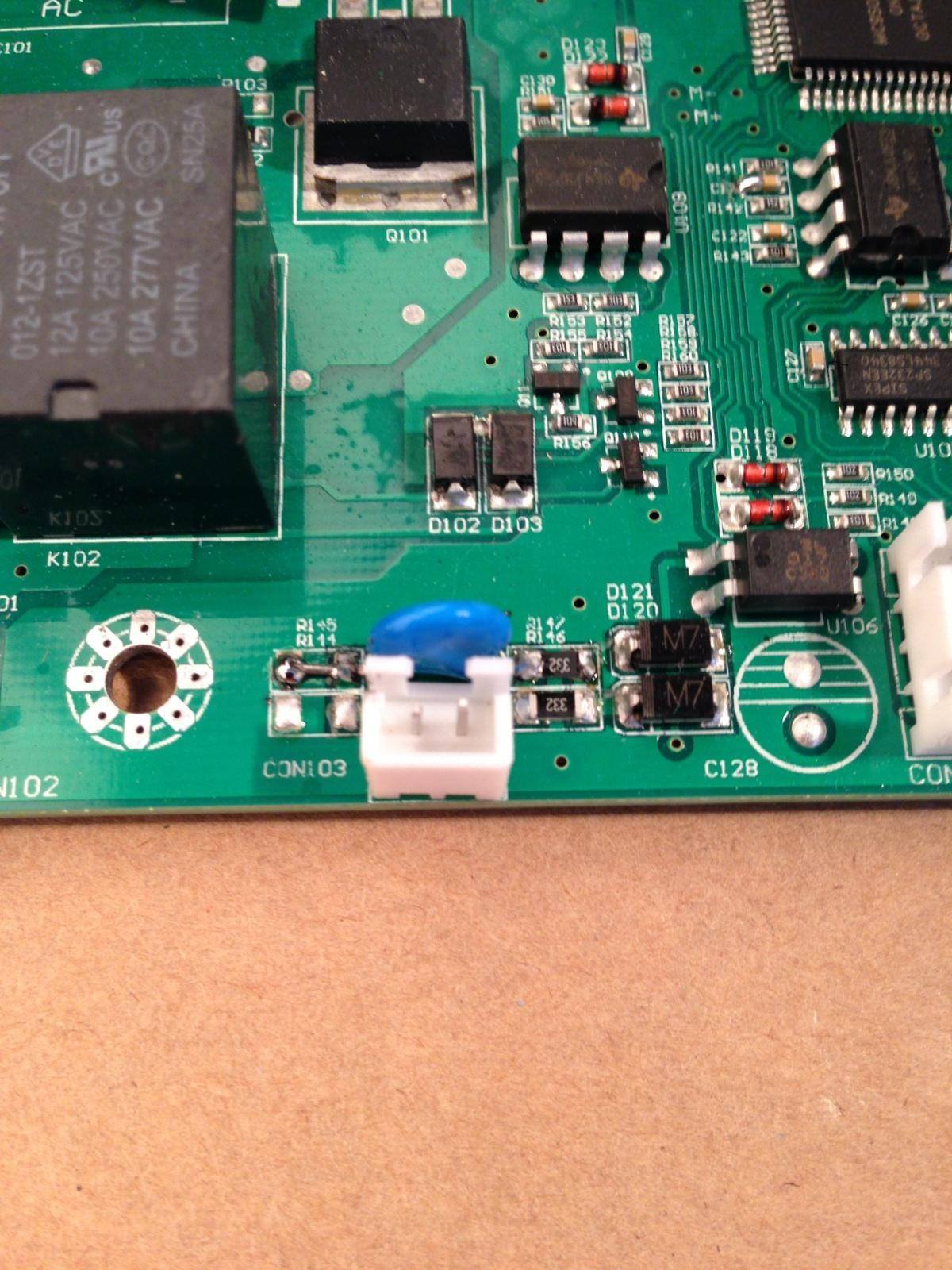

So I thought I would pass this along for guys out their that have the first run boxes and might want to tinker with it like I did. Here is the process:
On the main board to the left of Con103 there is a smt resistor R145 this is a 3.3K resistor for anyone wanting to know.
This should only be performed if you are experienced with soldering and smt. The resistor is in a 0603 package and is very small. It can also be destroyed very easy with too much heat. So take your time and be careful.
Below is a picture of the completed modification for reference.
- Remove R145
- Put a jumper where R145 was
- Take the 3.3K resistor you removed from R145 and move it across to the right side of Con103 and place it where it says R147
- Modification Complete
