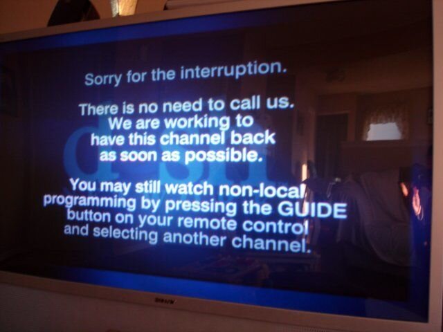

I live near Indianapolis, but "moved" my service address to Atlanta for HD locals. When I moved, Atlanta locals were CONUS on 129, but sense then they have added the HD locals on a spotbeam on 61.5 which I cannot get. So now when I try to tune to the HD locals, I sometimes get an error message saying:
"Sorry for the interruption.
There is no need to call us, we are aware this channel is unavailable and are working to get it back."
It seems that my 622 sometimes gets the locals from 129, but other times tries for 61.5.
I have one dish hitting 110, 119, and 129, and another hitting 61.5 for the Brazilian channels for my wife.
My question is, if I aim the 61.5 dish at 118 (which also has the Brazilian channels), will that solve my problem with Atlanta locals? And will I lose any of my HD channels? I currently subscribe to the HD-only package w/locals and Globo TV (Brazil).
I've tried to figure this out myself by looking at the channel chart, but I just wanted to make sure.
Thanks a lot!
Edgar

I have "moved" to Atlanta. I am NOT pointed at 61.5 and have no problem getting the channels. I believe they are still Conus. Where did you read that they were only spotbeamed?
Yes, you can solve the problem by moving the 61.5 dish to anything else. I had the same problem when the 61.5 spot was added to the 129 conus. I believe the default is to look at 61.5 if you have one pointed there. Remove 61.5 and you'll get a fine signal from 129 for the Atlanta HD locals.
I live in Indianapolis too and have Atlanta locals. Theyre conus on 129 and I have no problem getting them. Get rid of 61.5 and youll be good to go

You need a '+' dish (either 500 or 1000) to get 118 as it's lnb is encased along with 119.
Yep same thing happened to me with the Birmingham, AL locals. The receiver kept trying to get them from 61.5 instead of the 119 spotbeam. I finally bit the bullet and moved to Jackson, MS, no FoxHD though and their CBS-HD channel is so red and the colors are too hot. Have to adjust the TV every time I watch something on it.
