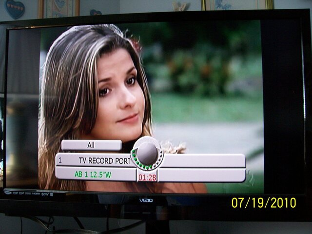

Only one of the two I get here is 11622 H 3255. I lose it when there are storms
off to the east as it is very low here. I'm pulling it in now with only occasional
pixelation. The SkyLogic data signal ACRadio refers to is always pretty strong
on that Sat.
A pic from this morning...
