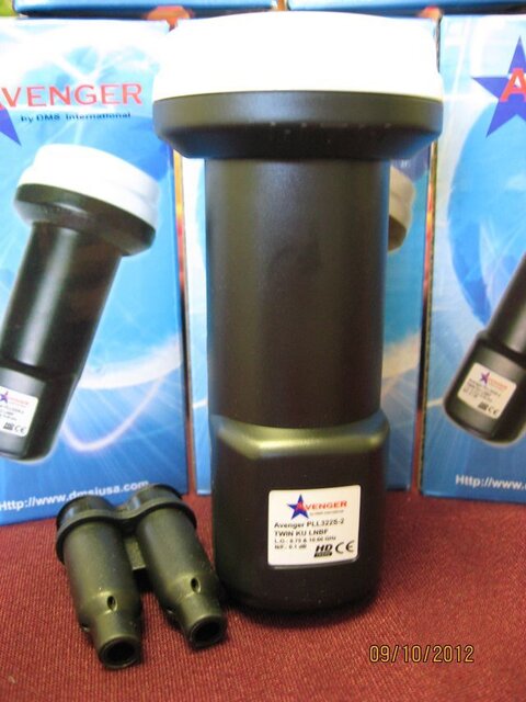

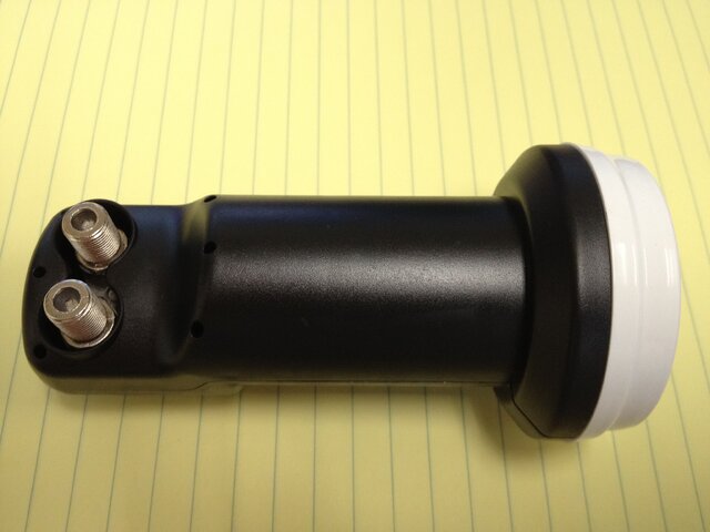

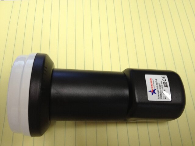

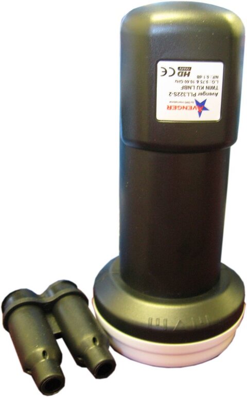

Avenger PLL322S-2 Twin Ku LNBF
Features:
• HD DVB-S2 Compliant
• Ku-band coverage for digital and analog
• High stability LO
• Low noise figure
• Digital ready
• Low power consumption
• Easy Installation
• 100% Water Leak Proof
