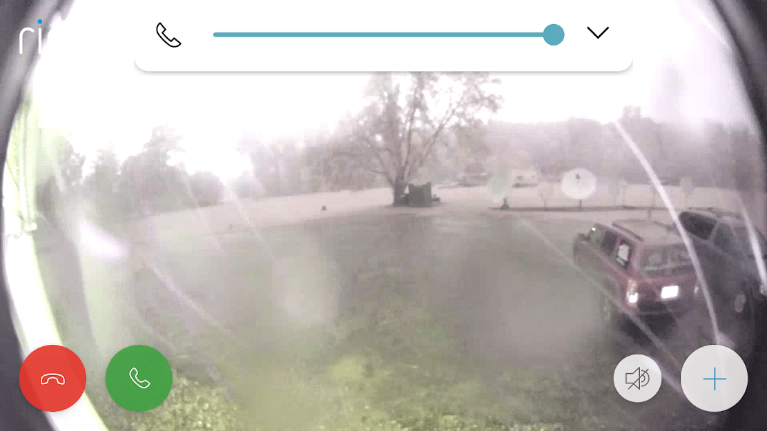

Last night we had strong storms in our area, which never bother my equipment. Either last night was the exception, or my positioner for the one actively motorized Birdview lost it's marbles.
The picture you see was kind of interesting. My RING security camera woke me during a strong 'bout of storms near midnight. The light, the wind, the rain made it think we had motion. The picture was snapped from a live RING feed to my phone with me repeatedly and manually taking screenshots, and I happened to luck-out and get one just as lightning hit nearby which made the dark of night look like day.
Now, notice...the Birdview white dish you can see in the "night into day" picture is aimed properly at midnight...at 101w.

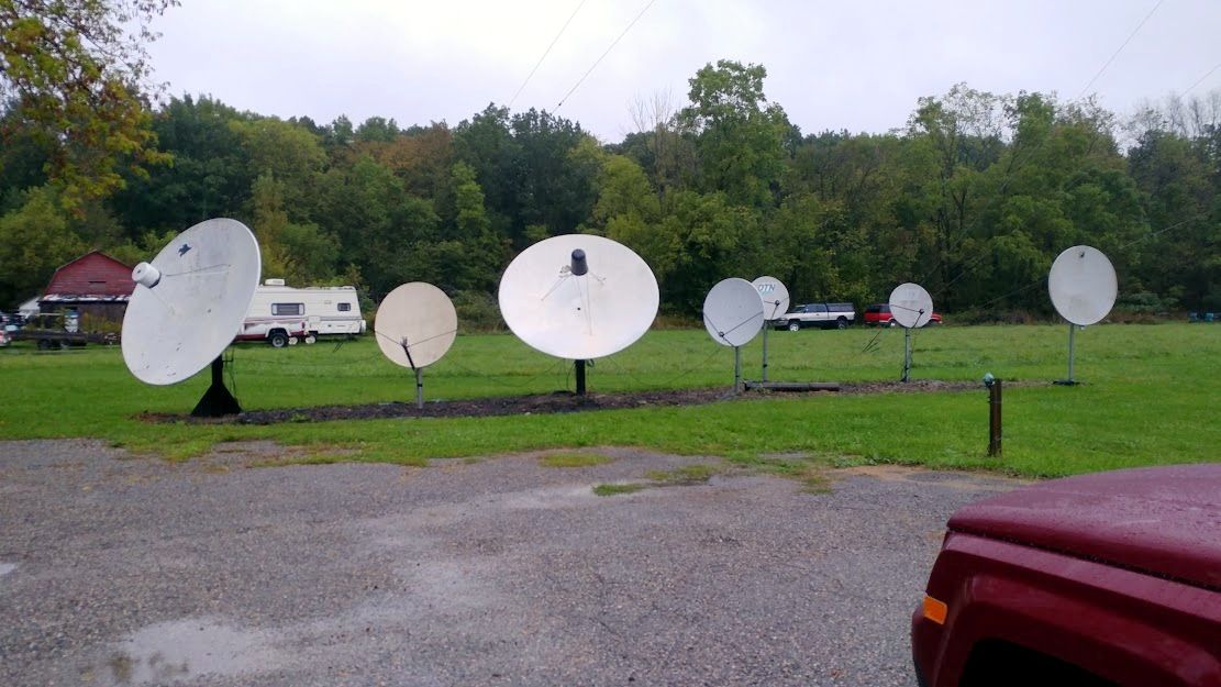

Later in the day, I walked out to our parking lot, and the dish is tight up against it's pole. No damage to the drive or the dish. (Birdviews are very durable.)
I must be nuts, but...even in our constant rain, I went out, snipped the zip ties holding the motor cover on the back of the dish, undid the common wires that are shared with the motor drive (custom built to work at a 5kw radio station)....and stood in the rain with my car's 12 volt jump box and the WONDERFUL satellite meter/tuner/spectrum analyzer which I bought a few years back from Titanium....and manually ran the dish back to it's 101 in just a few minutes, and found the Flinstones on Me-TV showing on the small screen! Success!! It took a while, given 1/3 the voltage going to the geared motor...but it ran smoothly.
I've bypassed the signal going through the positioner (cheap unit, never really had enough oomph to move a Birdview efficiently) and gone directly to the Amiko receiver. With the diseqc switches, I'll still have decent choice from the dish farm.

Hopefully there's still time before winter to plant (2) more stationary C-Band dishes, one for 99W, and one spare. With the one in the front yard aimed at 105 for audio, that may be enough to get through the winter.
I'll have to be on the lookout for one of the better dish movers, and restore that Birdview's mobility, but for now, we're at least back where it spends most of it's time.

Love that night-time picture where it seems like day. You can see the rain in streaks on the still, and the reflection of our night security lights in the station Jeep's license plate and rear lights...just to prove it was, indeed night.
