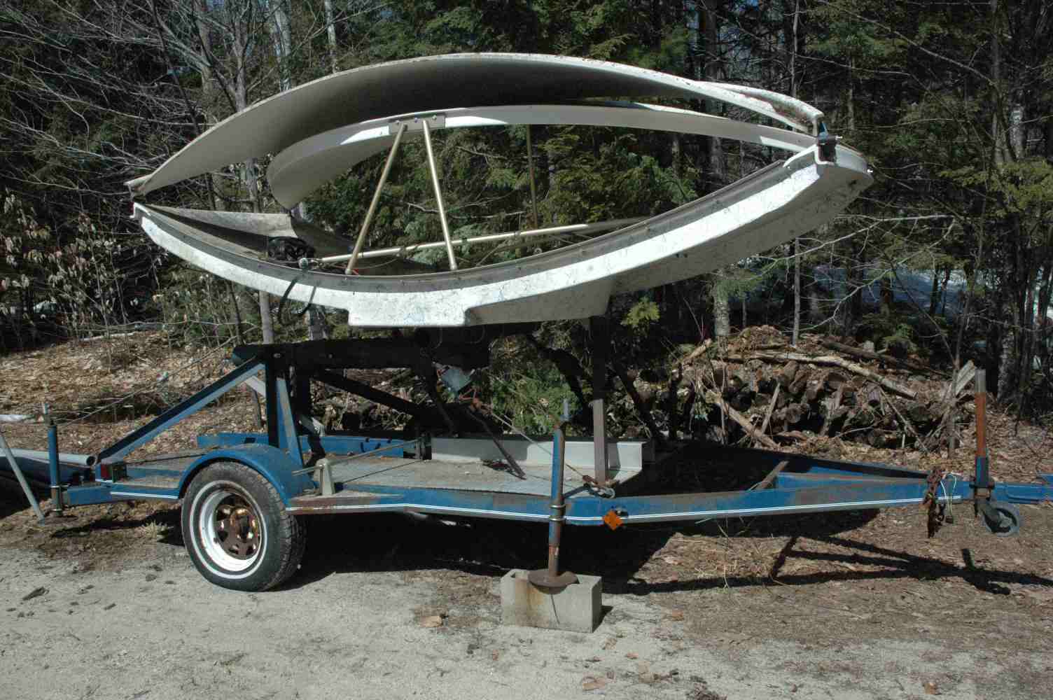

I was able to obtain a Comtech 12 foot portable C band dish. It is mounted to a trailer. I am going to set it up in my backyard but I am pretty sure 12 feet is going to do just fine. It is fiberglass. Does anyone have any thoughts on grounding it when I set it up? I was thinking of just planting a rod in the ground near it. What gauge wire should I use?
