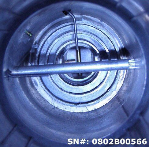

Nice day today, so I decided to tweak a couple of my dishes. 1 is a 10' stationary mesh dish aimed at 103 W. I installed a BSC621 on it last summer. Had to find a "happy medium" between C and KU, neither worked real hot, but OK enough to get programming.
skewing the BSC621 would pull the Ion channels in at 90+ but would barely show Pentagon on KU. Skewing for Pentagon would come in at 90+, but barely get the Ions.
I recently learned that the KU skew is off on that bird, so I looked for a way to skew C and Ku separately. When I examined the throat of the BSC621, I observed that the H and V did not align. I checked 1 of my Geosatpro CK1 LNBs and noticed that H and V did align properly on it. Checked another BSC621, and they didn't align either. I believe this would account for the poor KU performance many have reported using this LNB.
I loosened the 1/2" jam nut on the very end of the KU sectiion, where the cable connects, and carefully rotated and tweaked both the C and KU LNBs on 103W and tightened it back up. Ion & Pentagon are now both 90+. Careful though, it's difficult to hold the threaded nub and tighten the jam nut without rotating the KU LNB inside the housing. Needs wrench flats on it, but it can be done.
Anyway, I suspect that some of you who have had bad luck on KU with the BSC621, if you look down its throat, you might find that they're not in alignment. It's pretty easy to bring them into alignment with a little practice if they're off, mine were off a lot. The skew on most birds are the same on C and KU, but apparently not on 103. It's nice to finally have decent performance out of my BSC621.
I would be interested to know if anyone else has found misalignment between the H and V on C and KU on your BSC621.

Care to post pics looking down the throat of your fixed BSC621?

I was hoping skyscanner or anyone would post pictures of a well-working one inside the feedhorn so I have a reference to check against. :hungry:
I did check it back when I started but that means very little. :o :D
My probes form a T ( 2 overlap) but the Isolation bars are a + figure like in the bulletin. :confused:
There are pictures at dmsiusa.com/technical/bsc621t1.html their instructions for the fix aren't correct. 1st, forget about the polarity mark. All you have to do is make sure the isolation bars and V & H probes are all in alignment. If they're not, follow their directions until they are. They should not form a "+" like they say, everything should align.

Let me clarify: no need to loosen the 3 screws and separate the unit, just loosen the jam nut at the end of the KU section and rotate until everything in the C LNB and K LNB are in alignment. Carefully retighten the jam nut, making sure everything is still in alignment, it wants to move, will take patience to get it pegged. If you, like me, are using the 621 on 103W where the C and KU skew is off, this will also allow you to skew the C and KU separately.
