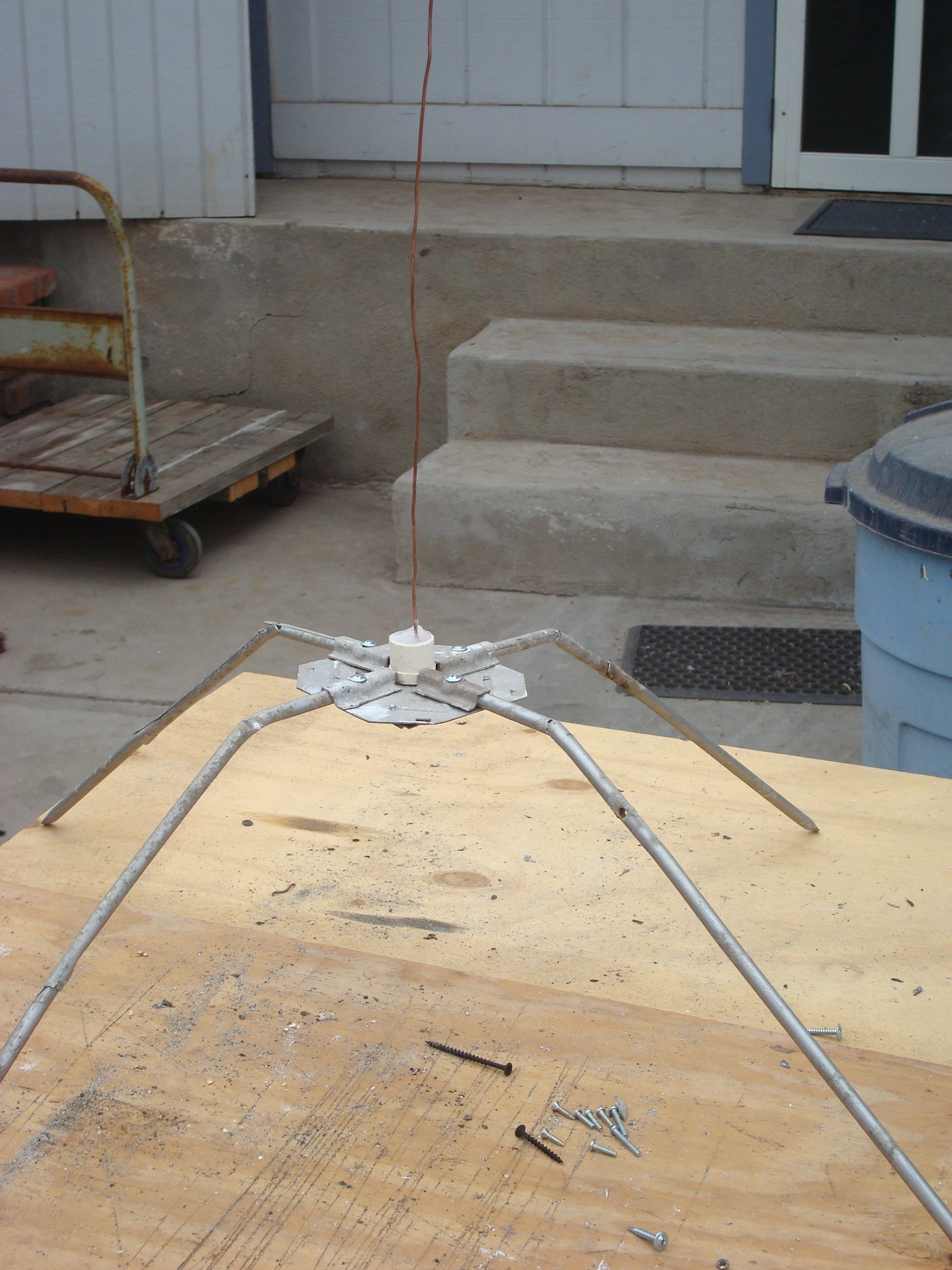

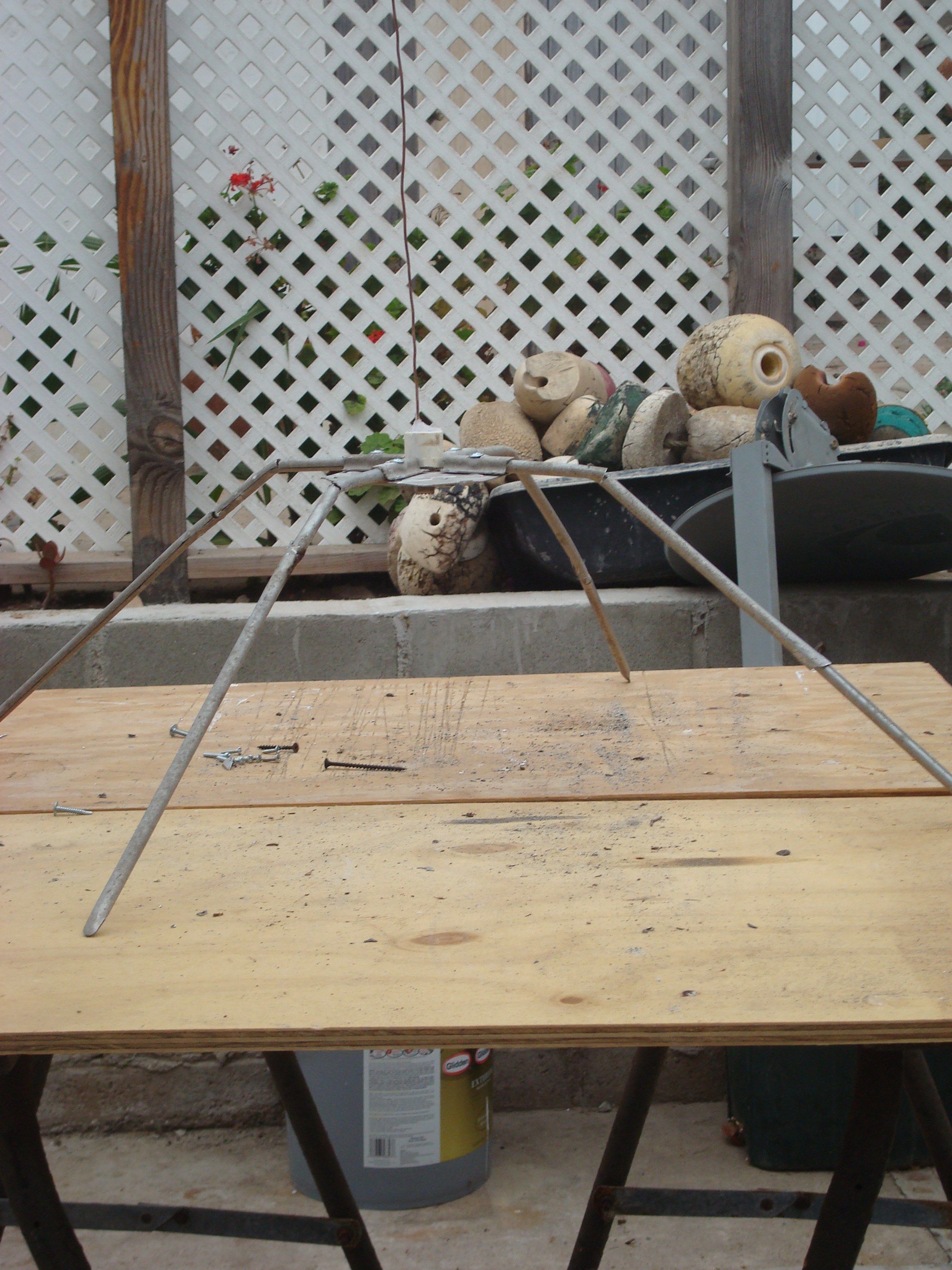

ANTENNA-STEIN; TAKE 1
Spent the afternoon going through my and a neighbor's scrounge pile and built this for proof of concept. Can't hook it up yet until I come up with the right RCA adapter plug and figure out the transition from the coax to the plug.
This dog have any chance of hunting? So far, $ investment = $0.00.
Once I get the concept down I plan to build a good one.
Interesting, kinda looks like a robotic alien grasshopper, lol. If you got the so-239 in there, with the center radial soldered in, and the legs of the antenna insulated from that, and attached to the outside of the connecter, it might just work. As far as the connection to the coax, some people don't even worry with one at the antenna-they just solder the center conductor of the coax to the upright , and twist the shield of the coax together and fasten it to one of the lower radials. It's really a simple thing to make, and so far, all of them I've made work great. Well, except that first one, and it was because I didn't seal it good enough to keep the rain out, it all corroded inside. One question: how are you going to mount it to a mast? Attach to roof maybe, like a big bug?
Thanks for not laughing - actually, I called it a LEM for a really small alien! My much better half got a good laugh out of that.
I did solder a 239 in scrounged from a 70's CB radio and filled the whole thing with silicone. Found an old 259 on a pigtail RG58 and fitted an OLD RG58 connector to make a transition to cable I can work with.
The RCA type plug to the unit is strange - has me stumped - nothing in my scrounge pile fits?
Had a good time today fabricating though.
I'm retired - time is my ally!
This is version 1.0 - if I can figure out the transition to RCA to the radio and it works, then I will build 2.0. Mount plan is a straight out piece transitioning to a 90 degree piece & either clamp or sheet metal screw to mount.
