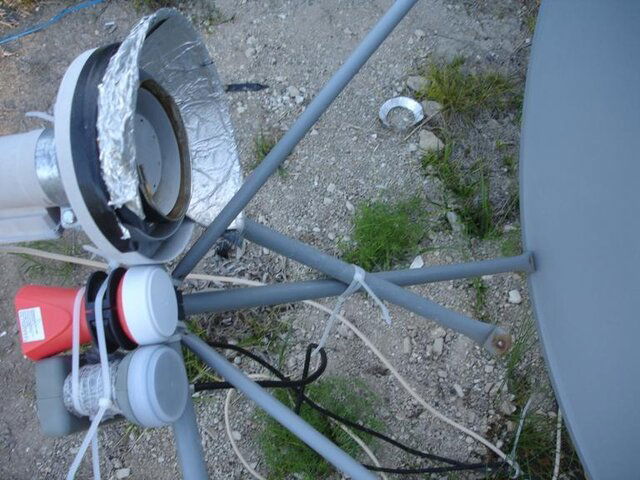

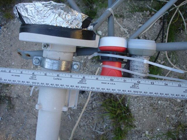

Is this what the C-band holder installation should look like then?

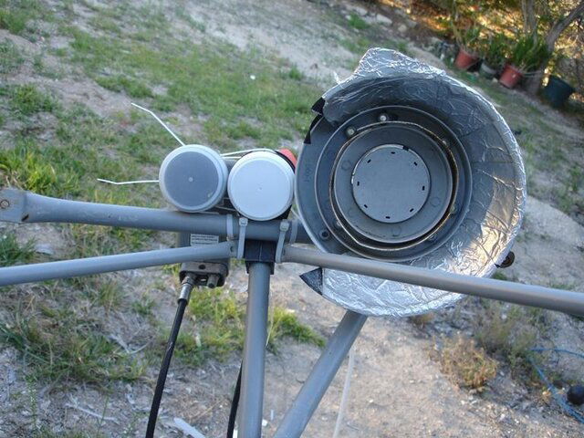

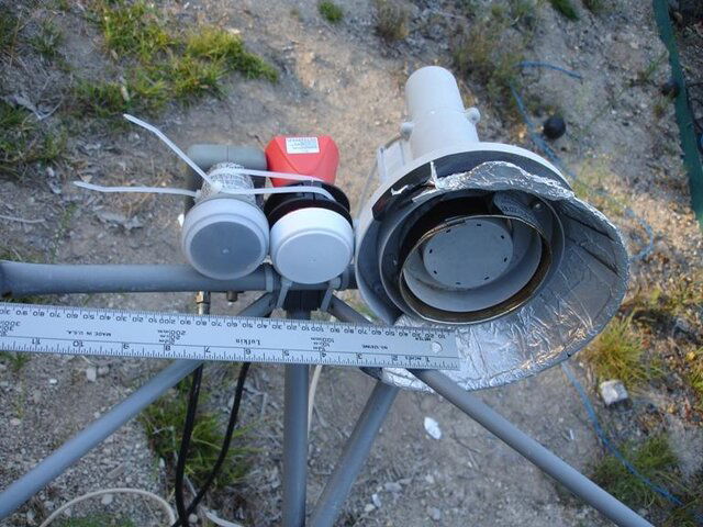

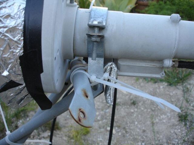

Babadem,
If you are referring to my posted (written) description, then yes. When I first assembled my dish using only the Ku-Band LNBF clamp, it seemed logical to install it as depicted in the assembly instructions (the sheet that came with the dish) but this obviously does not work when you add the C-Band LNBF AND the scalar ring. There just won't be enough clearance for the scalar ring with the struts installed according to the instructions.
You have the same GeoSatPro 1.2 M dish that I do, I believe. From SatelliteAV?
Before you get to actually aligning the entire dish, assemble it both ways (first with the support struts at the very end of the LNBF arm and using the Ku-Band LNBF holder) and then with the C-Band clamp with the support struts attached and bolted to the holes in the LNBF support arm a few inches closer to the dish.
I think you will be able to understand what I am referring to in this regard, when you see it first hand.
It can be easily switched as needed, but the dish elevation must be changed slightly if you do so.
Now, I did find that there was no great affect on the linear Ku band reception if I left it assembled with the support struts attached to the LNBF support arm in the mounting holes set two or so inches back from the end of the LNBF support tube or arm. I aligned my dish elevation for this assembly manner and just left it. Now I can swap the LNBFs out at will without readjusting the dish elevation.
But, as I stated, it becomes more apparent when you try it both ways first hand. Then you can see what I am referring to visually. It will make better sense to you.

Here are a few more pictures, if there is anything specific you want to see that the pictures don't show, let me know.

Thanks qwert1515! I will study those pictures intensely. :D It appears you modified the Standard Scalar ring to a semi Conical scalar. What kind of signal "Q" were you geeting before adding the modification?
Edit: What was the center LNB looking at when the picture was taken?
