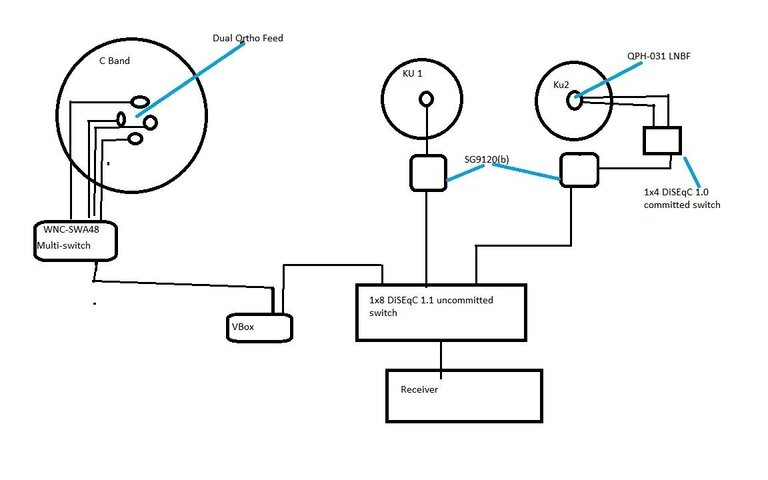

I use an 1X8 to connect both the VBox and SG2100 to the receiver

You are to inject 18-24v. into the modified switch from an external supply. I used a 19v. lap top power pack. The Micro set up is the same as your LNBF, 13v for vert, 18v for horz. The WNC switch will read the voltage and switch in the appropriate lnb. The coax voltage never gets to the LNBs as they are now powered by the external supply.

So you are running a 1x8 DisEqc switch off the back of your receiver, and it's still capable of controlling TWO KU motorized dishes, and still selecting from any lnb on the c-band dish to both ku band dishes without issues? Does a 1x8 switch work different then a 1x4 DisEqc switch? I didn't think they could pass enough current for motors.
Yes the switch will pass enough current. You can cascade switches of different protocols. In the diagram I have a 1x4 switch (DiSEqC 1.0) after the motor and after the 1x8 switch (DiSEqC 1.1). The modded multi-switch uses 22mhz tone control after the 1x8 Switch. Just as long as you don't use two of the same kind of switches behind one another. Not all switches pass enough current for a motor. You could stack a 1x4 switch on each port of the 1x8 and connect 32 LNBs :)
