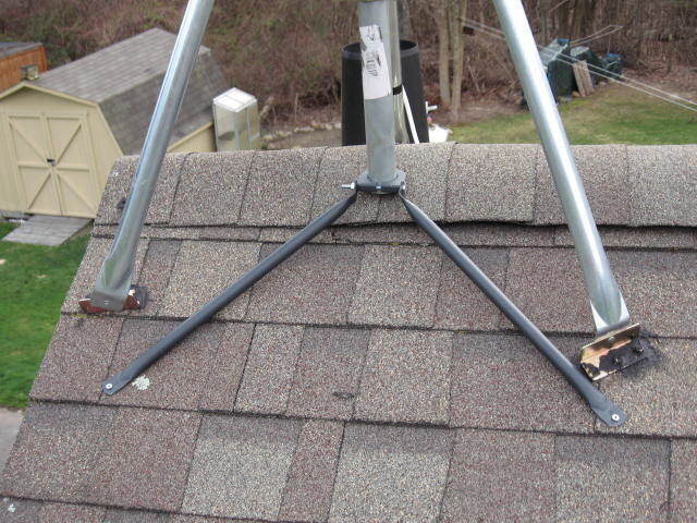

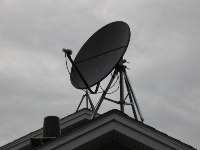

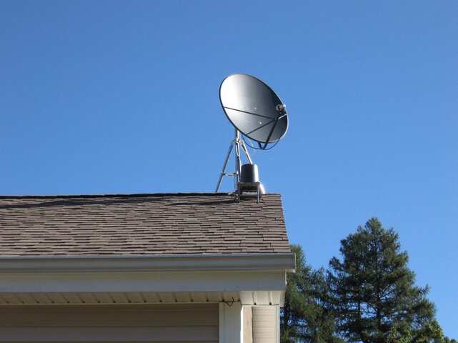

Heres a few pics of mine! A strong thick pole and a tripod did the trick for me.I used around a 2" pole mast that i ordered when i bought the tripod.if i was to do it again i think i would use a 2.5 to 3 " pole for better support.With the 2" i added the extra support shown in the middle pic due to slight play in strong winds.I have had wind over 50 mph since i put it up in the spring and its still holding strong.
