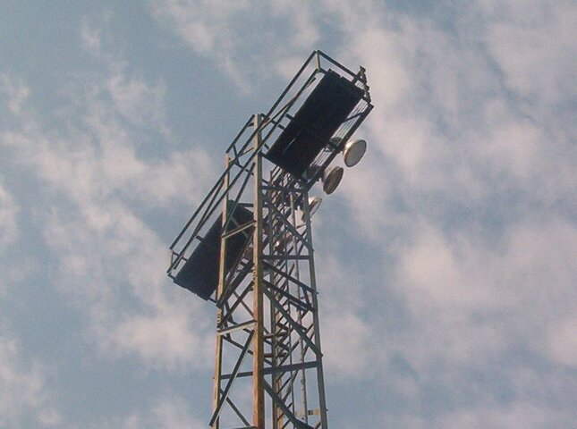

75 feet foot light towers in a 8X8 foot base ,10 feet in the ground . 16 X 4 decks have stood since 1934. wow and an at9 is going to tear out 160 lbs of concrete 2 feet in the ground , and the pole is 4 feet high! i really wonder how these towers have stood all these years, it is a wonder that joe montana isnt dead, hell this is his home high school field. they should have fell and killed him!:devil:
