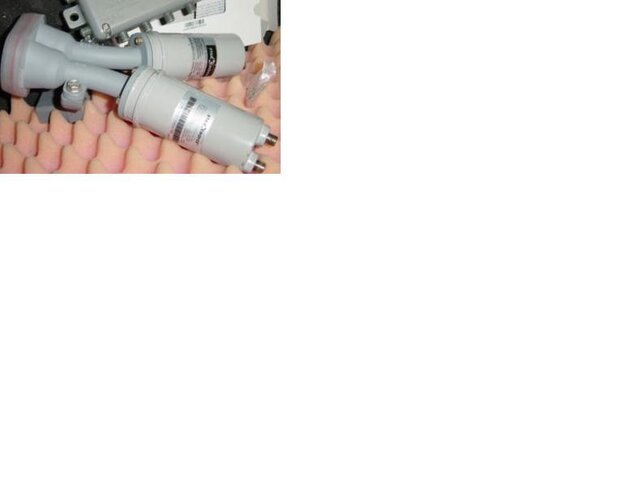

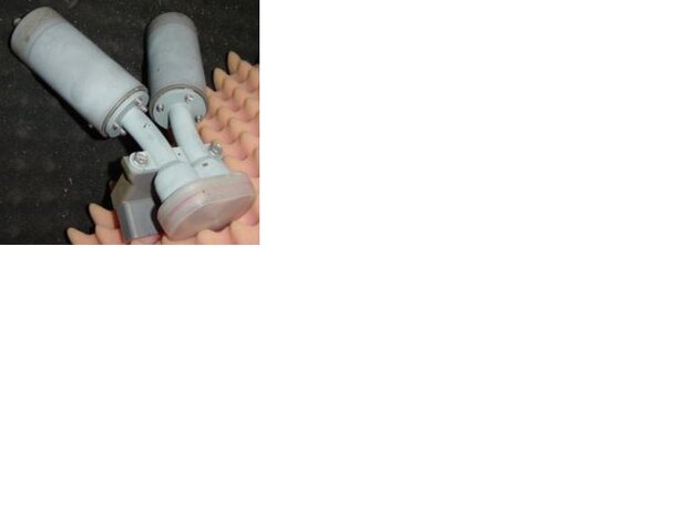

now i need to figure out what settings for the star choice lnb. (only one cable output per can) if that helps been reading just can't find the info on this lnb if universal or standard.
Also how important is it to use rg6 over 59 for FTA sats for the cables the ones I'm using 59 and are only about 5 and 10 feet long?
Those are stacked LNBs, so they send down both horizontal and vertical polarity at the same time (no voltage switching of polarities). You can use a L.O. of 10750 and blind scan (if your receiver supports this) to find your horizontal transponders, which will be above your verticals in frequency.
Or calculate 24600 minus the horizontal transponder frequency.
RG-6 is definitely recommended for any permanent/long runs of cable from your LNBs, especially with stacked LNBs, since the frequencies will run up to around 2 ghz. I would not be surprised if RG-59 did not work at all for those LNBs, or if it did, you might lose the horizontal transponders since they are at higher frequencies.

Apparently you may be able use a starchoice quad lnb to tune a fta satellite. One website I found describes how to tune the Starchoice satellites with a fta receiver (for wildfeeds). "Using the Star Choice elliptical dish (60cm or 75cm), set 22KHz to "0" on your FTA receiver if you are trying to lock on Anik F1 Mpeg-2 DVB carriers. Set 22KHz to "22Khz/On" on your FTA receiver if you are trying to lock on Anik F2 Mpeg-2 DVB carriers.
The L/O should be set to 10750 (Standard on most FTA receivers).
You can use any of the outputs of the Quad LNBF (they're all the same)."
So it may be worth a go after all, however remember to either skew your dish or rotate your LNB to the 11 o'clock or 5 o'clock position (east coast of canada) to compensate for the skew on the linear polarity satellites. It should work out better this way because Intelsat 5 (Galaxy 25) and AMC 4 are 4 degrees apart, the same gap as the starchoice sats are, so perhaps you may be able to get 2 sats on the same dish.
My 60e SC LNB was not stacked. You need 22khz ON so it uses the "center" lnb. It worked great for FTA, just the 60e was a little small of a dish.
