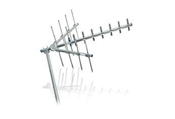

There is nothing special about an "HD" antenna. The HD signals are using the same UHF and VHF (depending on where you live) that analog signals used. You don't need to pay more for an HD antenna. Check antennaweb.org to find out how close you are to the towers. I would say you might need a good roof antenna. I am about 13 miles from my towers and I use an amplified UHF indoor antenna that I got from Target a few years ago. Didn't have anything about "HD" on the box.
Also check out TVFool for your post-transition results. Some channels in your area may be reverting back to VHF so you may need an antenna capable of VHF/UHF reception.
Radio Shack or Lowes/Home Depot type stores will have more selection especially when it comes to "large" antennas. Best Buy or Circuit City will focus more on smaller, indoor antennas or "cool" looking antennas, i.e. the type that look like airplane wings or flying saucers. One rule of thumb with antennas are if it looks cool, it probably doesn't work well.
The same 40-50 year old antenna designs people tore down from their roofs, chimneys, and towers work just great still today !
I live 40-60 miles from the antenna farms. According to antennaweb.com that distance required a giant outdoor antenna. I sent off my location to solidsignal.com. They sent back a checklist of everything needed to receive OTA in my area. Giant antenna, amplifiers, grounding and cables.
Like you, I live flat land Gulf Coastal. I could pick up a bunch of Digital stations with simple rabbit ears. Before investing $500 or more in a giant outdoor antenna I went to Wally World and picked up a small amplified indoor outdoor antenna. It worked with a 10' cable indoors. Outdoors on a long run it did not work. Wally World is great with returns;-) Exchanged it for Phillips Mant 510 50db amplified antenna and now can pick up stations over 80 miles away. I think the total number of Digital stations I receive is around 90. Digital stations go 66.1, 66.2. 66.3, 66.4,... One of the problems right now is weak transmitter signals. As the transition to all digital nears, station are upping the strength of their digital transmitions. It might be worth trying a cheap indoor antenna before investing in large outdoor antenna.

I have a CM4228 on a mast outside and I get the 42 mile antenna farm, the 7 mile antenna farm (between lobes almost in a null) and if I spin it around to the north I get Toronto.
I do not use a rotator, nor do I use a pre-amp, nor amplification of any kind. I basically have an "antenna on a stick" . The 20 foot mast at the gable end of my house goes from the ground up and it tethered at the gable with a 4 inch stand-off mount. Antenna is probably 5 feet above the roof itself. I'm shooting through thick pines and maples. I still get a great signal.

If you're trying for an 80 mile hit, you'll want to get some height as I believe 80 miles is "over the horizon" even in the flats. A cheaper antenna may work fine, but if it's a tough pull and you just need UHF, you might want to get a 91XG (only after seeing if something cheaper and smaller will work). With about a 25 degree beam width, if all your stations are clustered in that beam.... you would be all set.
