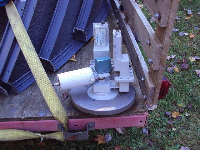

It was one of those original model 1's, that had two C-band lnb's as orthomode H and V, and a single ku lnb down the center that used a servo motor for H and V.
It included the lnb's, but I listed them as untested.
I think that was the early Bullseye feed. The older Corotors were only 1 C-band LNB
Yeah, Bullseye-1.
I got TWO 10-ft Winegard Pinnacle dishes, an Ajak HH mount, a bunch of actuators and such. I paid an extra $25 for the Bullseye feed. With what I made on just selling that from Ebay, I got everything else for FREE +.
Sometimes you get a bit lucky... But I think the Ebay buyer did ok himself, he saved a couple $100 over the full price of all brand-new versions.
