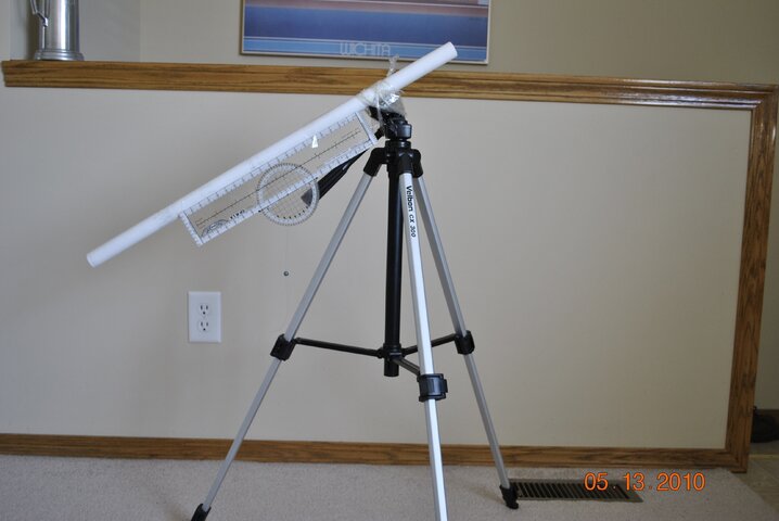

I put this together and mounted it to a camera tripod and I have been puzzled,as it sits here it is showing a 30 degree elevation but when I take out my 18" DTV dish and use the scale on the dish @30 degree the DTV dish looks more like about 20 degrees it has a more shallow elevation,which should I trust?
Does this piece of PVC look like its at 30 degrees?

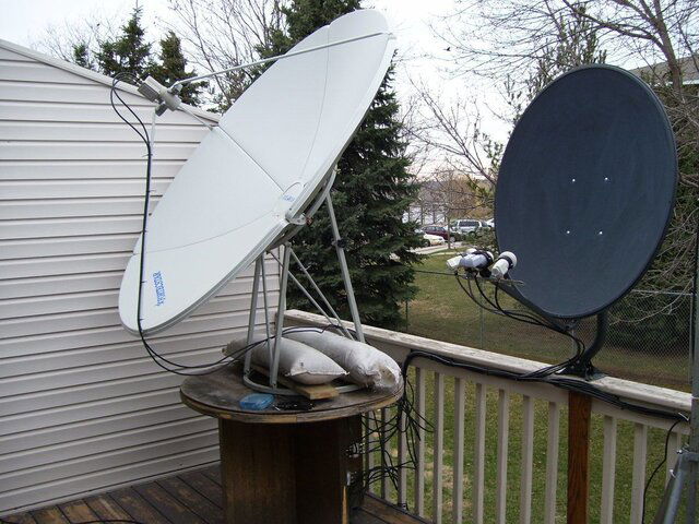

you have to remember that KU dishes (and DBS) have a 22-25 degree offset so the dish will look like its lower
Here is a good example I have posted a few times
The 6 foot dish is aimed at 99W which for me is 38.4 degrees. Its prime focus so the angle looks "true"
The grey dish is aimed (at the time) at 97 & 93 which 93 is my true south so its 38.4 degrees too. Look how that dish looks like its vertical because its offset by 22 degrees or so

Iceberg,I was looking through this device I cooked up because I have a house with a peak next to me and was wondering if my line of sight will miss it at 30 degrees,I looked through the PVC pipe and it misses it but I was worried about putting a pole in the ground and cement and all then I find out that my elevation calculation was wrong..{{{nervous}}}..so..when I look through the PVC pipe will that give me a true 30 degrees?
Is there a better way to determine if I will miss the peak on the home next to me?

If it clears the house showing at 30 on the inclinometer then you should be OK
on an offset dish the signal comes down from the sky, hits the dish and bounces to the LNB. SO even though the dish looks low the signal would clear it

You may trust both indications. They are correct. As Ice stated, with an offset dish, it "appears" that the dish is "looking" lower than it truly is. That is part of the nature of an offset dish.
If you could aim a LASER beam out of the dead center of the dish, it would NOT point at the satellite you are truly aimed at. It would hit 22 to 26 degrees below the satellite. Remember that the inbound signal and the dish are akin to a beam of light and a mirror, a curved or parabolic mirror, and the signal comes down to the dish from an upward angle and is reflected in a lower angle down towards the LNBF.
It isn't as apparent to the naked eye, because we cannot see the signal beam, but if you try to envision it as a mirror, with a single beam of light striking it, you can start to realize it more appropriately. The satellite is much higher in the sky than you think it is, remember this.
Your device (clinometer) tells you the accurate story.
