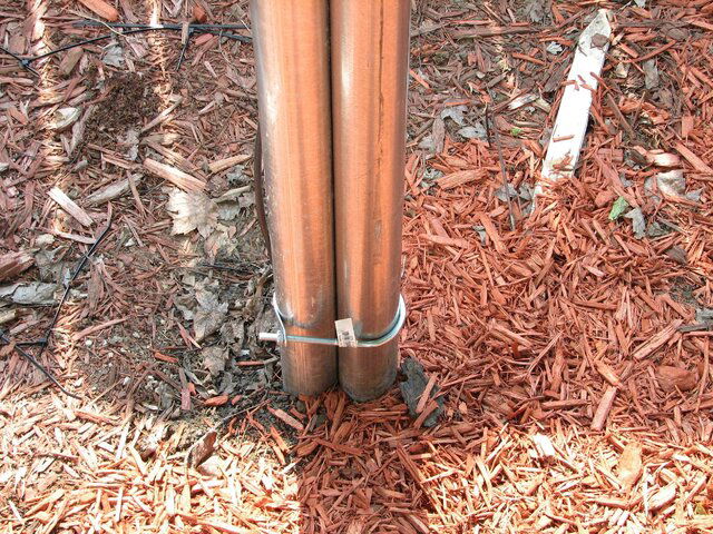

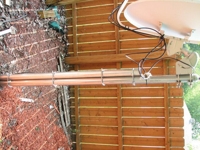

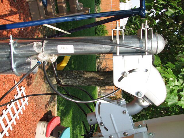

here's pics of my setup. Again, these posts are filled to within a couple inches of the top with cement. Both poles are sunk 2 feet into the ground. Lag bolts through both to prevent twisting. Btw, I used the quick drying cement.
Motor is about 6 feet above ground (clear the fence) and it's been up for just about 1 year now. No twisting or anything as occurred and during heavy winds I rarely notice the dish moving (yeah I went out and watched one day).
Wiring is kind of a mess as I was playing with swapping a 22khz with a diseqc last week and have not finished tying things up.

Great! That helps clarify quite a bit and I thank you for going through the trouble of taking the pictures!
However I am not yet seeing those lag bolts...
I also note that you orient the pole pair on a North-South line - do you think it would work any better or worse going East-West? All speculation of course...
The lag bolts are probably in the cement. I didn't put any in mine and the pole would rotate when gusts of winds hit it. But after about a year, the pole quit rotating, Cement must of swelled up... which was a good thing for me.
My only regret on my install was not putting cross-members through the pole. Lag bolts would work great.
You can't see the lag bolts cause they are buried in the cement in the ground :) I don't have an x-ray camera. They prevent the poles from turning or twisting. I drilled holes through, put the bolts through and threw a nut on the end, didn't tighten it up much, just hand tight.
I suppose the N-S orientation is not the most ideal, but honestly, I don't know if E-W would be better. I have no noticeable flex in the setup I have with the winds I experience. Even with the dish turned to the west.
