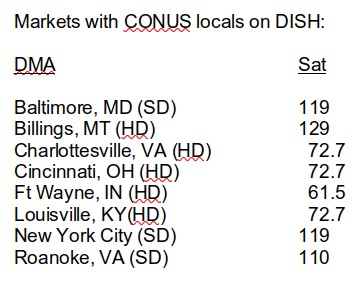

Here's my current list of Dish locals on CONUS beams as verified by James Long's locals list.

The service address on his account is within the NYC DMA, but his physical location is not. He can receive the NYC locals in SD on the 110 and 119 CONUS beams. There are other DMA's available in HD on CONUS beams.
