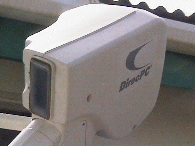

Just want to make sure that the original LNB (pic attached) can be used to get FTA and I don't have to buy a new FTA Ku LNB. Correct?

I think you may have to take the plastic covers off it and see what is inside. Mine had a tag that stated L.O. was 10750. It will probably work, at least for one polarity.

yes that LNB will work fine...the rectangular one will work for KU. There is a pencil LNB next to it and that is DBS

Iceberg: Do you remember what settings for the LNB? is it "Standard " Ku LNB with 10750 L.O. ?
Can use this dish and LNB to get the vietnamese channels at TP 11966 22000 H ?
yes
If you take that plastic shroud off the back of the LNB (there are like 5 screws) it should be on a red sticker. But it is standard/single and 10750 LNB LO
IceBerg,
I took the plastic cover off the feedhorn and there is a red sticker on the LNB, which had this information:
DirecPC LNB
FSS 11.7 - 12.2 GHz
HNS P/N 1029272-0002 Rev. A
Made in Taiwan
It does NOT mention anything about standard 10750 LNB.....

yeah that is fine. Will work with 10750 LO
