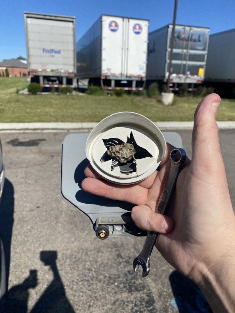

So went on a service call today because 8 rooms where not working.
It was originally wired in the walls with 1 Dish. Apparently another tech couldn't figure it out. Drilled holes in every room and ran 42 lines to the roof.
Issue was a bad LNB.
I did not do this job BTWView attachment 145741
When I first glanced at the first picture, I thought it was a dead bird. Guess I need glasses....

I think it was a residential tech that didn't know how to fix an issue with a SWM system.
His solution was to run all new wires and install 7 dishes

Pretty much clueless.
Customer wants to pay us to clean it up. I don't know where to begin.
Do I keep the lines the other tech ran to the roof, or do I try to fire up the swm system and use the lines in the walls.
I'm actually thinking of just getting rid of all the dishes, home running the splitters back to the main electrical closet and being done with it.
You do have to clean up the mess, then install the standard commercial hotel/lodging D2 advantage type cabling and equipment from the dish on down to the SWiM splitters and homeruns to the rooms don't you?
Reverse Band 5 legacy LNB dish on an NPRM sled ---> pol. locker ---> trunk amplifiers ---> parallel DSWM-30s, etc. ...?
