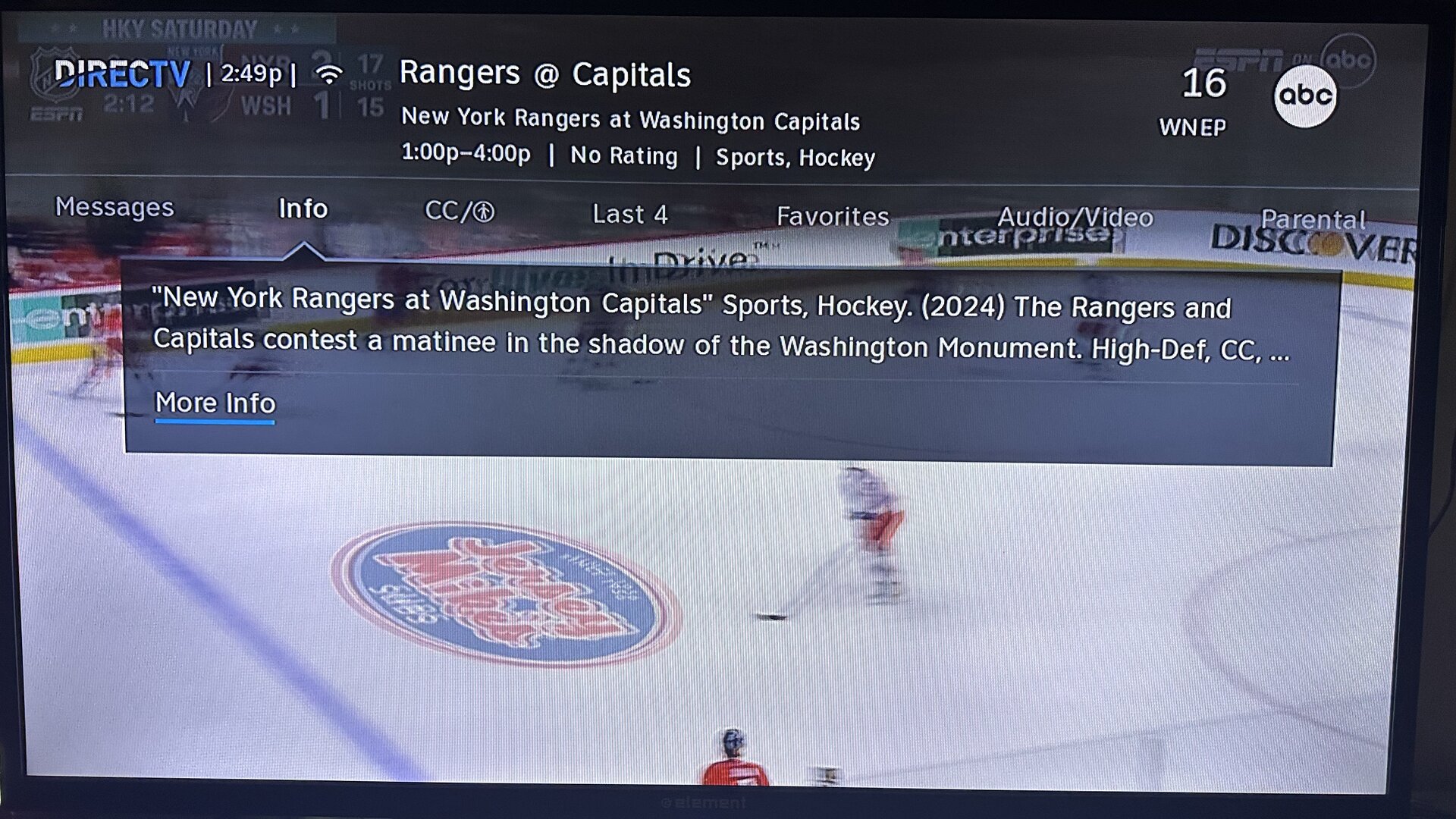

Do you know if they still temporarily make DNS feeds available to customers whose local stations are off the air? WOLF/56 has been off the air since early last night (just showing a black screen) and I'm not sure if that means we can, in the interim, tune to 398 to see FOX programming.
No they don't. Everything from Penobscot except WNEP/WVIA went off air at around 7pm when the storm knocked out power at Penobscot. WBRE/WYOU returned to air around 11pm when it was safe enough for their engineer to get up there to turn on a backup generator, while WOLF (and WQMY via 56.3) returned about an hour ago when power was restored. WSWB and WQPX come from Bald Mountain so they weren't affected by the outage.
On a side note, for obvious reasons, outside of a special 7pm newscast, 457 TC International has been off air since yesterday afternoon with a "We will be back soon" graphic on screen.
